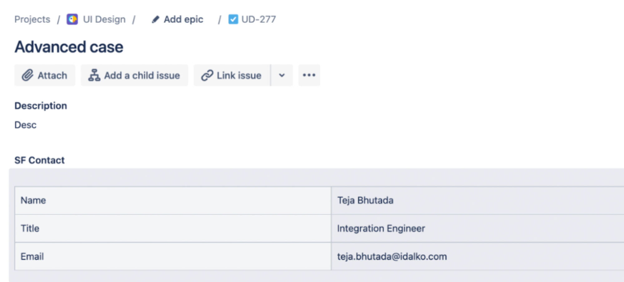

Now coming back to the incoming sync on Jira, it’s time we display the fetched Account and Contact details.
As seen, the details are displayed in custom fields called ‘SF Contact’ and ‘SF Account’.
Line 26, 39: Check if the type of entity received from Salesforce is Account or Contact and depending on it, the details are displayed further.
Line 36, 37: Name, Title and Email of the Contact are displayed.
Line 42,43: Name and Description of the Account are displayed.
Additional fields from both these Salesforce records or some other Salesforce record in itself can also be displayed this way.
Note the ‘|’ and ‘||’ used here are just to display the data in the form of tables. It has nothing to do with Exalate.

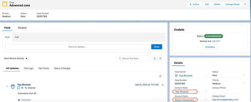

We start by creating a Case in Salesforce and assign a Contact and Account to it.
Then sync it over to Jira (either manually or through triggers).
In a short while, under the issue created in Jira you can see the Account and Contact related information being displayed under the 2 custom fields in Jira in the form of a table.
Open the Exalate panel on the issue view and you can see the Account, Case and Contact sync status and also their respective remote links.
You can try making some changes to either the Account or the Contact in Salesforce and see those being reflected in Jira.
