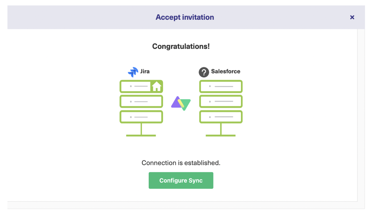

Once the Connection has been created, you need to configure the Sync Rules.
These rules are Groovy-based scripts that control what information to send and receive between the 2 platforms.
You can click on the “Configure Sync” button after the Connection has been set up to configure these rules or you can also edit the Connection in the “Connections” tab in the Exalate Console.

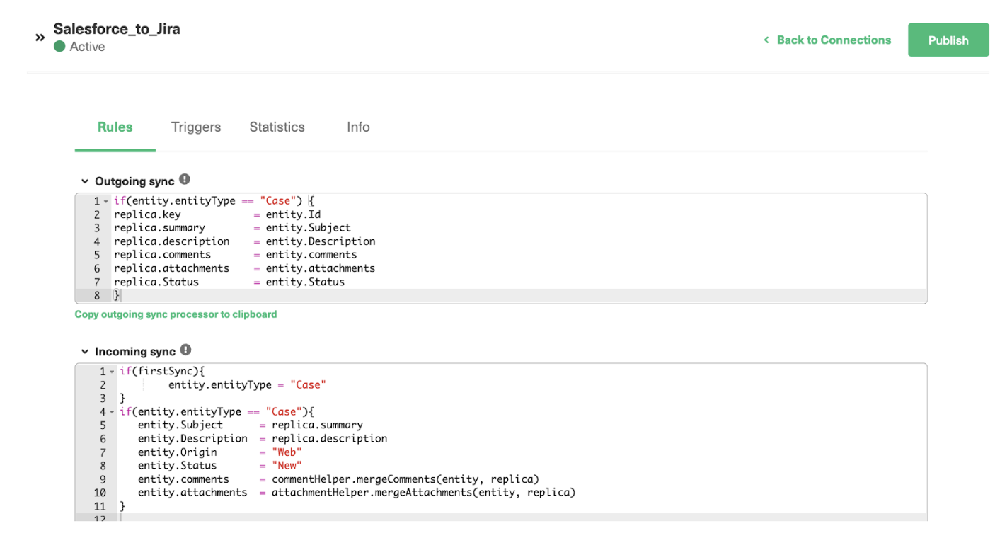

The scripts you see are generated by default when the Connection has been created. So common fields like summary, description, comments, etc are already there and can be synchronized out-of-the-box.
Now, we need to edit them to accommodate our sync requirements.

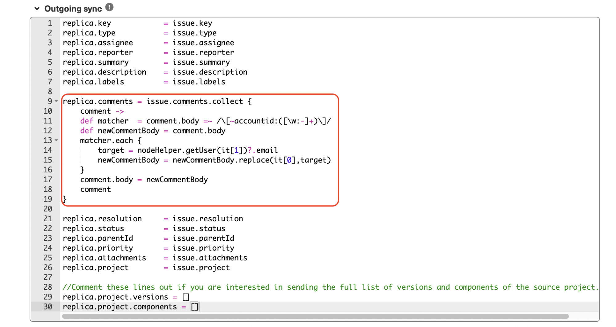

Jira: Outgoing Sync
replica.key        = issue.key
replica.type       = issue.type
replica.assignee   = issue.assignee
replica.reporter   = issue.reporter
replica.summary    = issue.summary
replica.description = issue.description
replica.labels     = issue.labels
replica.comments = issue.comments.collect {
    comment ->
    def matcher  = comment.body =~ /\[~accountid:([\w:-]+)\]/
    def newCommentBody = comment.body
    matcher.each {
        target = nodeHelper.getUser(it[1])?.email
        newCommentBody = newCommentBody.replace(it[0],target)
    comment.body = newCommentBody
    comment
replica.resolution = issue.resolution
replica.status     = issue.status
replica.parentId   = issue.parentId
replica.priority   = issue.priority
replica.attachments = issue.attachments
replica.project    = issue.project
//Comment these lines out if you are interested in sending the full list of //versions and components of the source project.
replica.project.versions = []
replica.project.components = []
The Outgoing sync looks like this
Here’s what happens in the script:
  • The collect method iterates over the comments array of the Jira issue and transforms them before assigning them to the replica (to be sent to the other side).
  • The transformation taking place is at the heart of handling user mentions. The script extracts them in the comment body and replaces them with the email address of that user instead. The replica will now contain the comment not with the Jira-specific mention, but rather with an email address corresponding to the mentioned user.
Note: Replica works as a payload to pass information between the two applications.

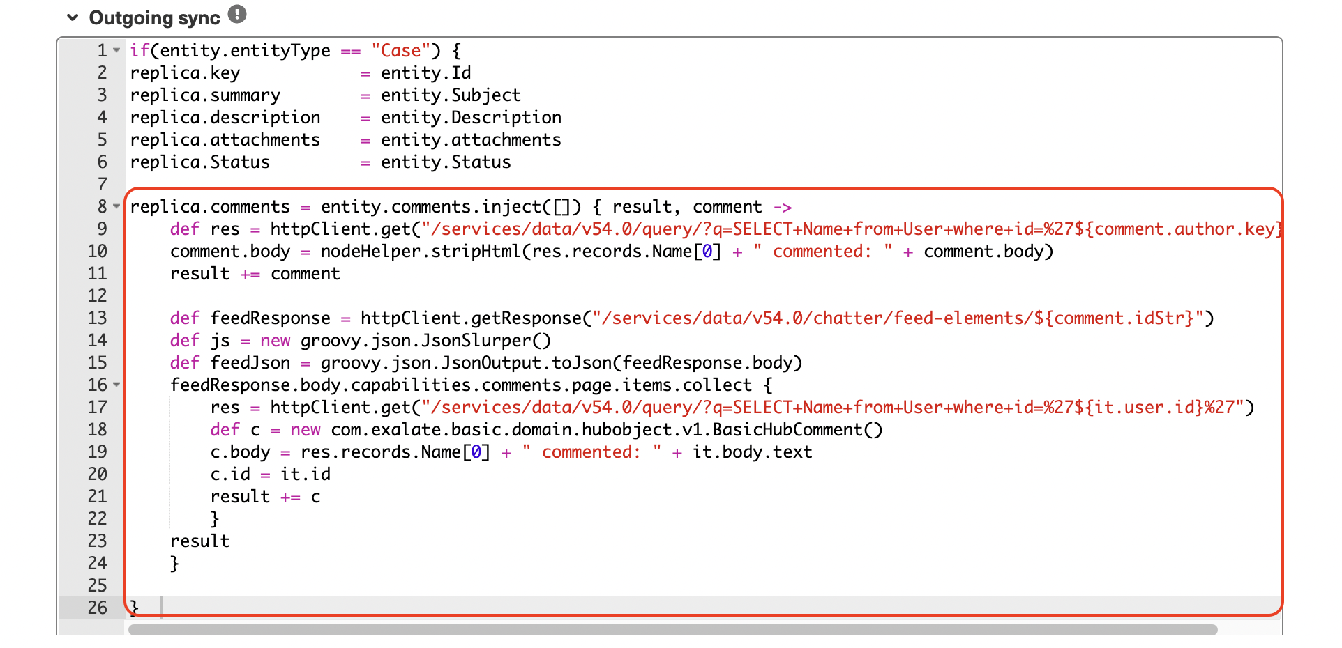

Salesforce: Outgoing Sync

The Outgoing Sync script looks like this.
  • The inject method iterates over all the comments and performs several operations:
    • For each Salesforce comment, the script first fetches the username of the comment author and appends it to the comment body (so that it can be reflected on Jira as such). In addition, the script employs the stripHtml() method to transform the HTML formatted Salesforce comments into plain text to be properly reflected on the Jira side. We add this main comment to the result variable temporarily.
    • For each Salesforce main comment, the script then fetches associated threaded replies and populates them in the feedResponse. Each of these threaded replies is then sanitized by removing HTML and appending the author's name to the comment body. They are then added to the result variable.
    • This result, once the iterations are over, contains the main comments and threads that have already been transformed. It is then assigned to the replica to be sent over to the Jira side.

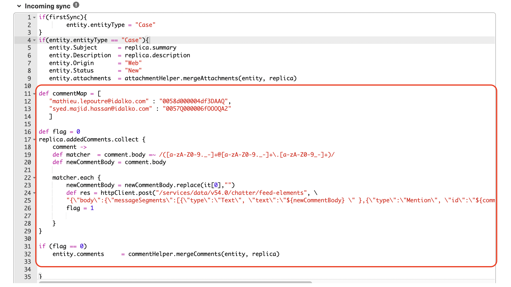

Salesforce: Incoming Sync
if(firstSync){
        entity.entityType = "Case"
if(entity.entityType == "Case"){
  entity.Subject  = replica.summary
  entity.Description  = replica.description
  entity.Origin   = "Web"
  entity.Status   = "New"
  entity.attachments  = attachmentHelper.mergeAttachments(entity, replica)
def commentMap = [
  "mathieu.lepoutre@idalko.com" : "0058d000004df3DAAQ",
  "syed.majid.hassan@idalko.com" : "0057Q000006fOOOQA2"
def flag = 0
replica.addedComments.collect {
    comment ->
    def matcher  = comment.body =~ /([a-zA-Z0-9._-]+@[a-zA-Z0-9._-]+\.[a-zA-Z0-9_-]+)/
    matcher.each {
        newCommentBody = newCommentBody.replace(it[0],"")
        def res = httpClient.post("/services/data/v54.0/chatter/feed-elements", \
        "{\"body\":{\"messageSegments\":[{\"type\":\"Text\", \"text\":\"${newCommentBody} \" },{\"type\":\"Mention\", \"id\":\"${commentMap[it[0]]}\"}]},\"feedElementType\":\"FeedItem\",\"subjectId\":\"${entity.Id}\"}")
        flag = 1
if (flag == 0)
    entity.comments = commentHelper.mergeComments(entity, replica)
The Incoming Sync script looks like this.
  • Remember that when sending comments from the Jira side, we replaced the user mentions with the email addresses. So, in Salesforce we create a mapping called commentMap that maps the email addresses to the corresponding Salesforce User IDs.
  • The next step is to iterate over the comments contained in the replica and for each comment extract the email address, map it using the commentMap and then replace the email address in the comment with the Salesforce mention of the mapped user.

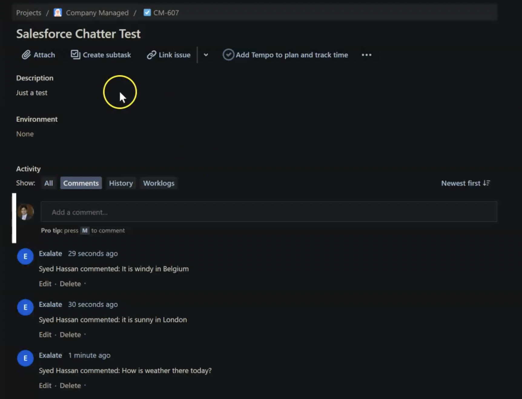

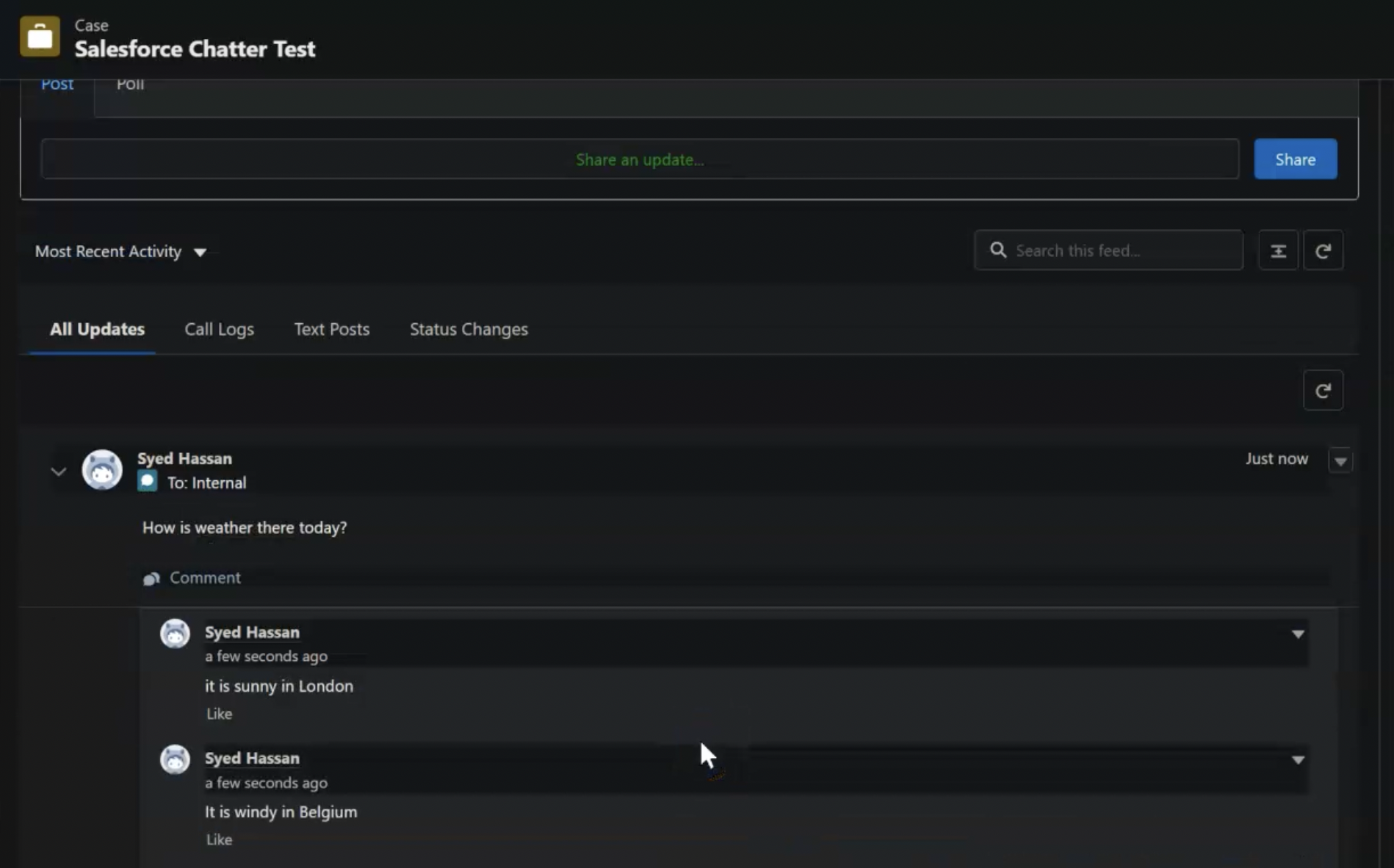

Once the code is inserted into the respective outgoing and incoming syncs, comments, and threaded replies will automatically be reflected in Jira.
 So when you insert a threaded comment in Salesforce.
All of them get reflected in Jira.

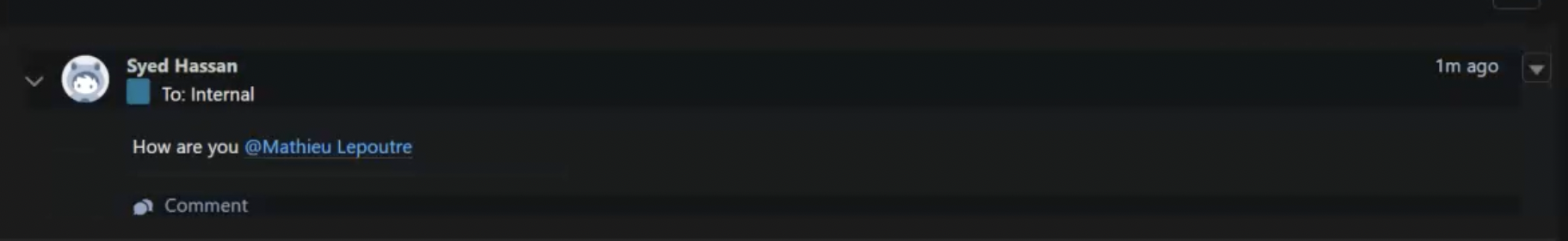

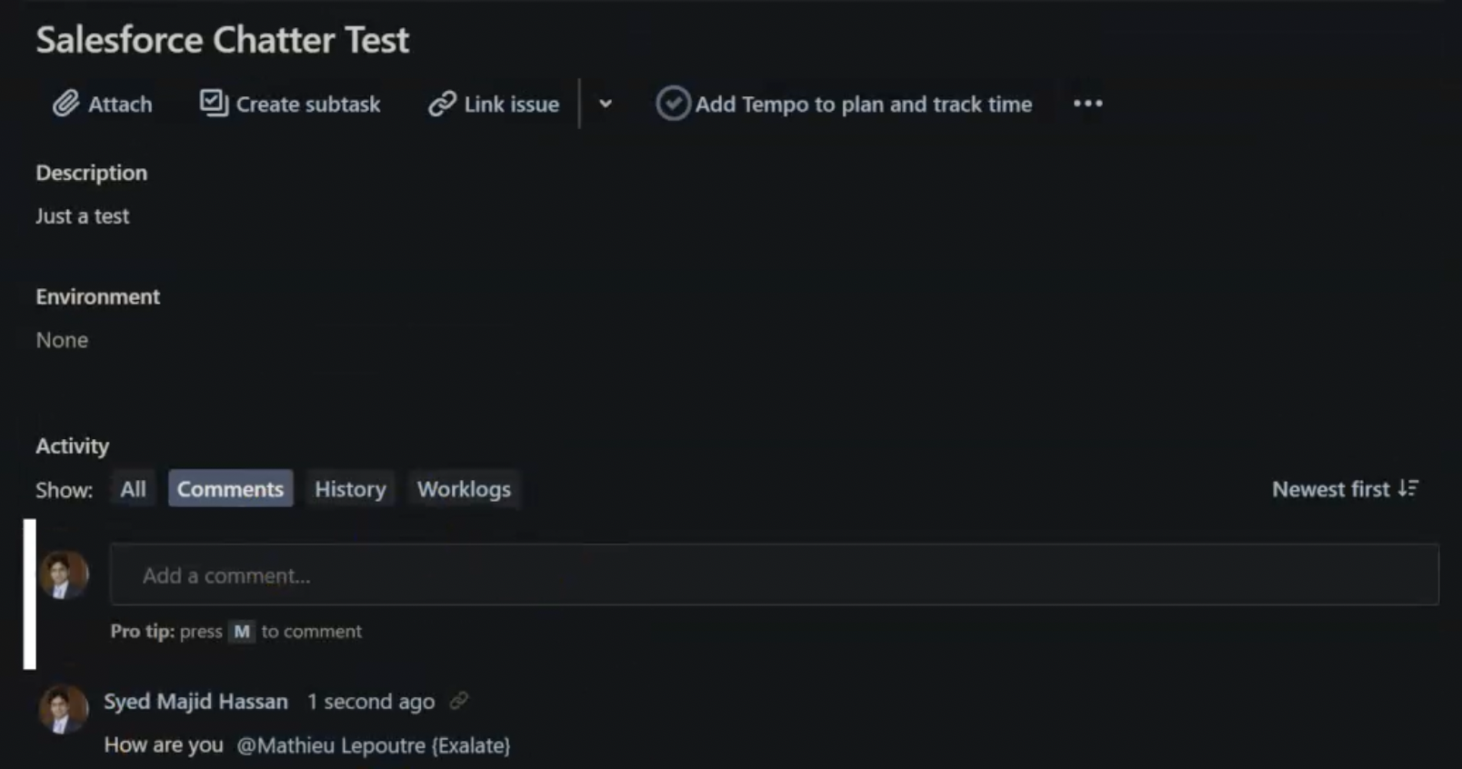

Also, user mentions in Jira will tag the corresponding user in Salesforce, if he/ she exists.
So mention a user in Jira.
And see the corresponding user being tagged in Salesforce.
