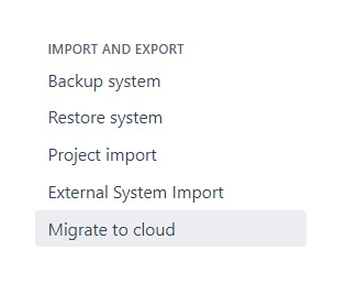

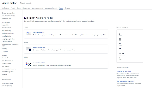

In the admin section, system subsection, find the “Migrate to Cloud” option. This will take you to the JCMA interface. Unless otherwise stated, this is the place we’ll keep coming back to. It should look like this:
Obviously your numbers for Groups, Users, etc will be different.
We will perform the three steps outlined above, in that order. But there is one special step needed in part 2 that isn’t mentioned in the JCMA walkthrough proper. You can find the details in our wiki page.

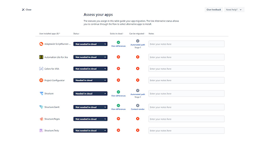

This is a check to make sure you indeed have the latest version (or at least, a version compatible with the current JCMA version). It will list all your apps and give you the option to indicate whether each is needed in your new cloud environment.
Our example shows a few different options. We will set the status “needed in cloud” for just Structure, and not for the others. In your particular migration you may want to include all the apps you intend to migrate. Please note, there isn’t currently a migration pathway for Structure.Gantt — please track our release notes for updates on that.
Some notes:
Notes are purely for your own reference later in your migration configuration. This table of options can be converted to a CSV file and downloaded if you choose. When we select "Done," we are brought back to the JCMA main page.

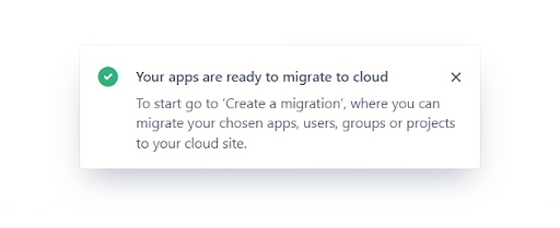

If you've completed the first two steps, you'll see this message pop up:
Not so fast! There is one more step covered below.

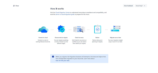

We are now going to create a migration.

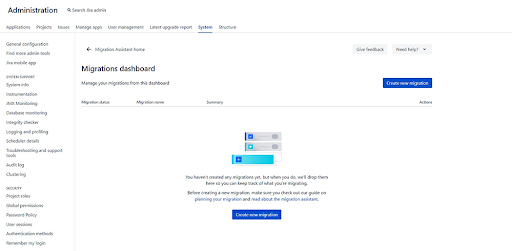

Your migrations will be listed here. We are going to select “create new migration."
In the next menu, we will give our migration a name and point it to a cloud instance where we want to move all our data.

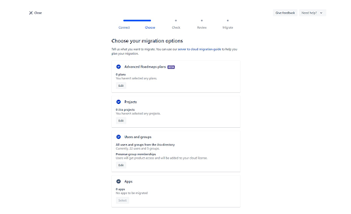

Our next menu will ask us to select what data we are going to migrate.
Select all your projects. If you select the empty box in the top left of the screen, it will select all your projects in this screen, not all the projects. You need to do that for each page here.
Migrating users and groups over will be important because those links will also need to be preserved for ownership of structures, views, and permissions.

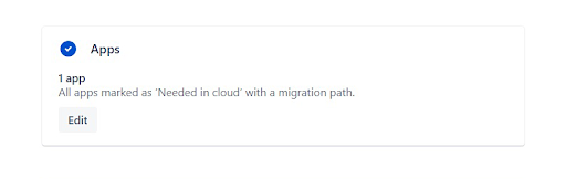

After that we will select the apps to migrate.
It is important to note that selecting Structure here is not enough to migrate structures over. We still need to create a structure migration configuration.
If you proceed to migrate from within the JCMA, no Structure data will be migrated.

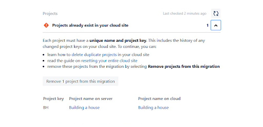

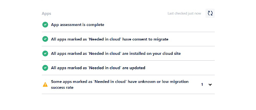

Proceeding to the "check for errors" phase next, you will almost certainly run into errors. You’ll have warnings about user tiers not lining up, groups and project permissions, etc. You will also see an automated message, as below:
Yellow warnings are not critical and will not prevent your data migration. But red warnings must be dealt with before going to the next step. The explanation of the problem and possible ways to resolve it will show up under the warning.

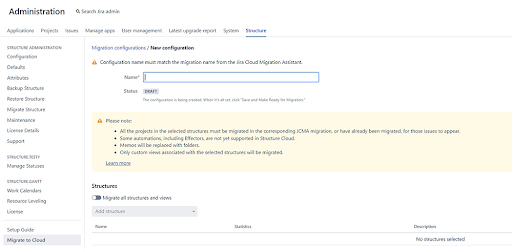

At this point we are saving our Migration Set (do not run it yet!) and going to create Structure migration configuration. Go to Administration | Structure | Migrate to Cloud and create a new configuration there. Give it the exact same name you used for the Jira migration set created earlier. If the names do not match exactly, Structure data will not migrate.
Here we also have the option to choose which structures we want to migrate or just take it all. Just make sure that Jira projects behind chosen structures are also included in the migration package.

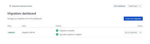

Return to Administration | System | Migrate to Cloud and run the JCMA migration we’ve created. You’ll see the progress bar showing the status of operations.

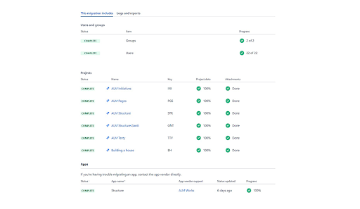

With a bit of luck we will see in a couple of minutes that all data has been migrated successfully and we can move to the next step.
If we click on “view details” in the current migration action menu we can check individual statuses of each migrated item, as well as download logs and error reports.
But you might also have a case where app migration progress stays in “spinning wheel” mode for a long time. That doesn’t always mean something is wrong, so don't panic — first we need to check what app data we now have on the cloud site.

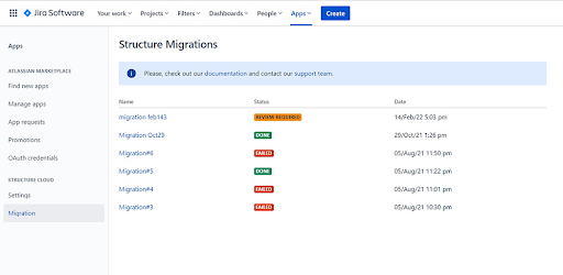

Go to Jira Cloud site Settings | Apps. In the left panel, locate the Structure Cloud section, and click "Migration." This will bring up a list of migrations with the status of each. If your current migration status is marked with a green “Done” or orange “Review required” sign, that means our data has been successfully migrated and one or several structures need to be reviewed. We can now go into the Structure app itself and inspect those one by one.
