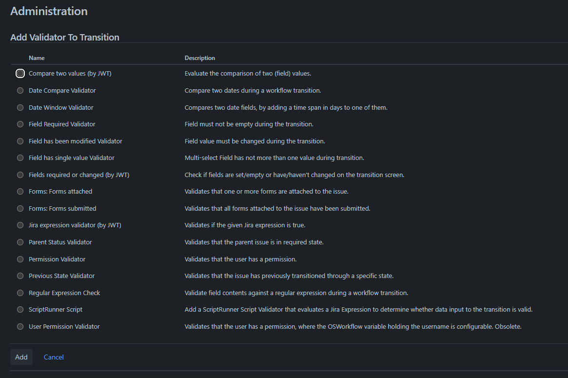

Is it possible to add validation that would require issues from only one team to transition to the next status and the rest of the teams can bypass it for an issue type used by multiple teams? Was thinking I could use the Jira express validator with maybe the board's filter, it would be only one person who can advance the issue to the next status.
We have multiple teams in one project and would not like to create a separate issue type or project just for this team.
