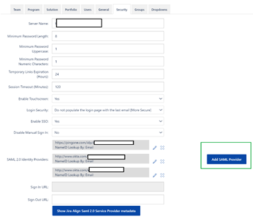

Supporting Multiple Identity Providers or Multiple Configurations from a Single Identity Provider
  1. Configure your first Identity Provider SSO Solution as per https://community.atlassian.com/t5/Jira-Align-articles/Video-How-to-enable-single-sign-on-SSO-with-Jira-Align/ba-p/1296205 and https://agilecrafthelp.zendesk.com/hc/en-us/articles/115000374174-10X-Jira-Align-SSO-Support
  2. Create a second set of IdP metadata in your original IdP or an additional IdP
  3. Navigate to Jira Align Admin > Platform > Security > Click “Add SAML Provider” and paste in the 2nd set of metadata
Notes:
  • The “Sign in URL” field will be grayed out until “Disable Manual Sign In” is set to Yes.  It is recommended to validate SSO configurations before setting “Disable Manual Sign In” to Yes
  • Jira Align only supports a single “Sign in URL” redirect which means users will need to navigate directly to the sign in URL of additional IdP configurations.  A good technique for doing this is users adding the additional IdP configuration sign in URLs to their browser favorites.
