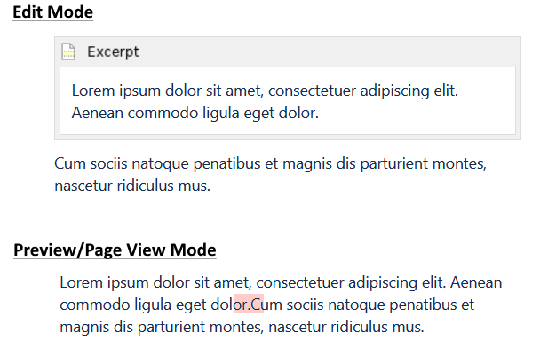

This has bugged me several times now: I frequently add a page excerpt macro, containing some lines or paragraphs of text, followed by another paragraph of text - outside the excerpt macro body. During edit mode, both elements appear as two separate paragraphs/blocks.
However, when (pre)viewing the content, the excerpt content and following paragraph are just concatenated as illustrated below (see how there is not even any space after the "." as highlighted in red):
Is this a defect? Is there a way to have the paragraph following the excerpt block be displayed as a separate paragraph?

From your example, it appears that you haven't started a new paragraph below your excerpt macro, causing your browser to read it as an inline macro.

While this approach appears to result in the correct rendering, I still suspect that there is an error below this.
Looking at the storage format, your approach results in

So there is an additional <p><br/></p>, while in reality, the following text is already wrapped in <p> and should therefore display as its own paragraph.

No, I did follow you recommendation, the (blind, not latin) text below the additional <p><br/></p> does display in its own paragraph. That part is ok.
However, looking at the storage format, it bugs me that the "separator" <p><br/></p> is needed to achieve the desired result, as the following text is already wrapped in <p>...</p> -- shouldn't this result in the text being displayed in its own paragraph, even without the preceding "separator"?
Actually, when I manually change the excerpt's atlassian-macro-output-type to BLOCK (instead of INLINE) in the storage format, then it seems do display fine as well, even without the separator. However, this option does not seem to be available from the UI.
Bottom line: your way does result in the correct display, however it seems more than what the storage format would suggest.
