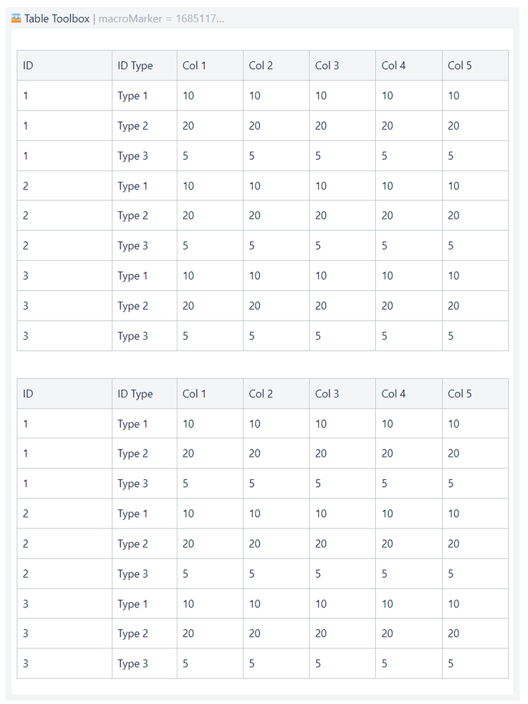

Seems that there is smth wrong with the example of your table: if every ID has three types (and your last sentence points at that), then the existing 'ID' column should be named 'ID Type' or smth and there should be another separate column for the 'ID' itself.
Please see the screenshot below:
Fri 7-1.pngHere when you filter by the 'ID', you'll get three rows (Type 1, Type 2, Type 3 for each ID). Let us call this variant as option 1

At first, place the two copies of your tables inside the Table Toolbox macro. Here I manually copied my table twice but this was done for simplicity. In real life it is better to reuse your table with the help of the Table Excerpt/Table Excerpt Include macros. So, if you need to update your table, you will work with the source table and the updates will be pushed to the reused copy automatically.
Then go to the Table Toolbox macro and create the following macro sequence inside its shell:
Each table is wrapped in the Table Filter and then in the Table Transformer macro (let's call them internal). And then everything is wrapped in another Table Transformer macro (external).
