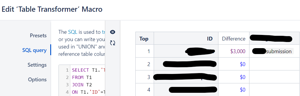

I encountered an issue which previously did not happen for using 2-layer Table Transformer structure. My structure is as below:
Table Transformer 1
  Select T1.'Top'
     Table Transformer 2
      Select ROWNUM() AS 'Top'
The issue is that Confluence can not read 'Top' after published (as below image), but in Table Transformer 1's pre-view it is ok with desired result (as below image).
Could you suggest how to fix it?
Thank you.

Hi Katerina,
Thank you for the feedback. The structure you reproduce matches my case, and the major difference I think is that actually the T1 and T2 in my case are more complicated, which are generated from several sub-tables using "table excerpt" tool for leveraging. The complete structure is as below images FYI.
For the SQL queries, I checked with autocomplete and all columns can be found. Also the result can successfully show in Table Transformer's preview when in Confluence edit mode, so I think it is not syntax or logic issue of SQL queries, but rather other reasons that may be related to compatibility with other macros, such as Table Filter and Table excerpt/excerpt include, or app version like you mentioned.
Would you like to provide some comments/insights on the compatibility issue part?
For app version, I'm trying to contact our Confluence admin to check.
Thank you.
ps. I wish I could use more simple structure, but consider our application, data source comes from another macro "Confiforms" and SQL rules, This is so far the best way I can think of to meet our needs. It is so close to full solution that we made it in the preview... really hope it can be seen on published page too.
