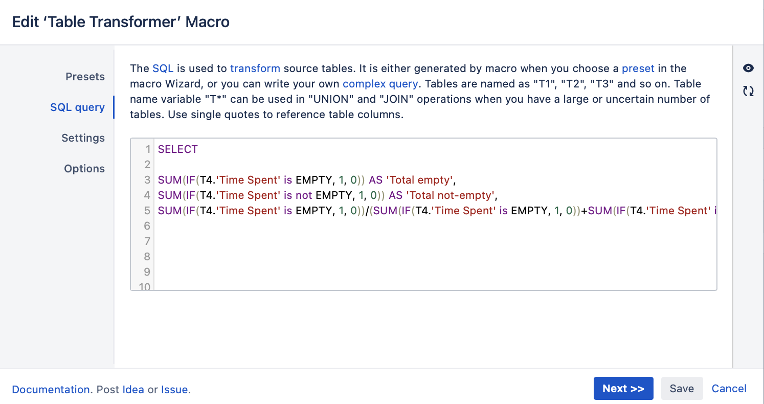

Im dealing with a very basic case Im not able to make it work, to count the amount of tickets out from a given JIRA filter that has a specific field empty.
I've tried the following expressions to count the total tickets with field "Time Spent" empty vs the non-empty ones (irrespective of the value), so I can calculate the percentage out of those 2, but does not work for this case:

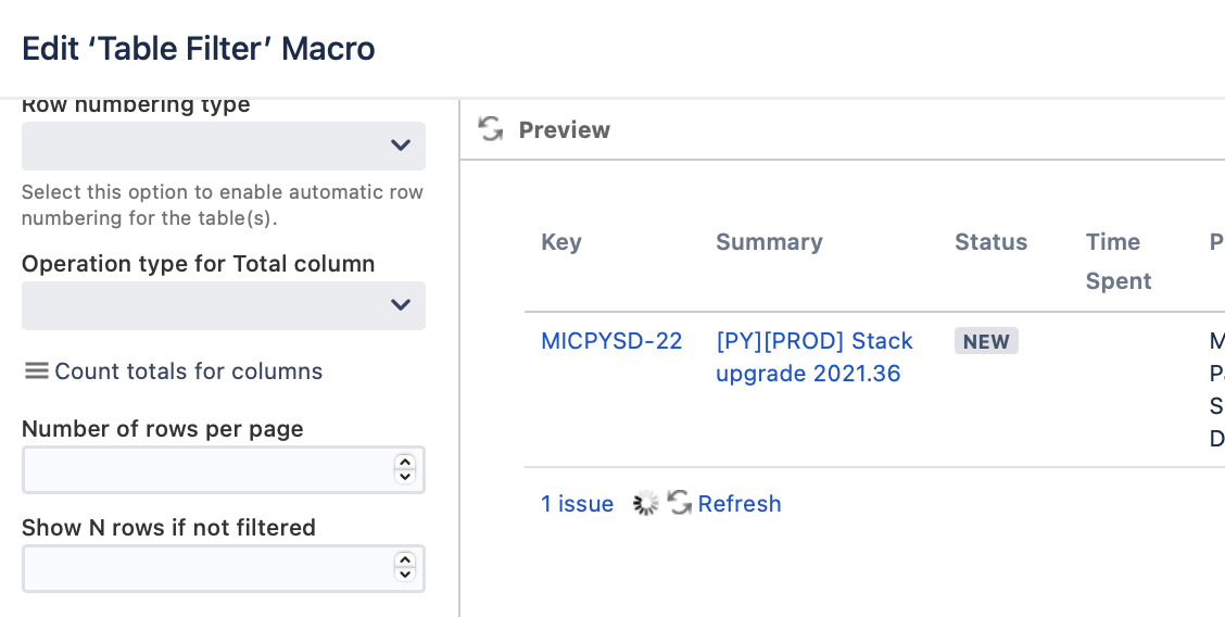

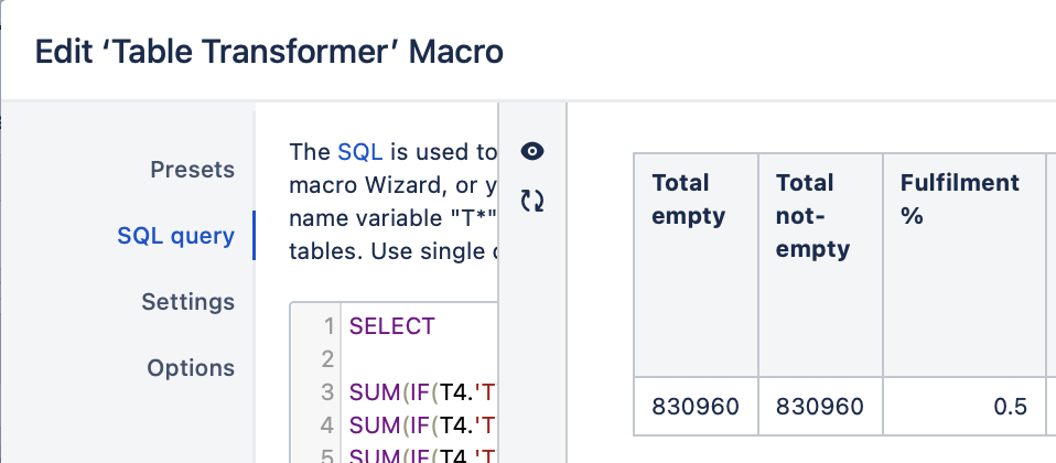

I've tried with with "= EMPTY", "is NULL", "= ''", etc... but get either error or weird results. In the case Im using, for simplicity purposes I have only 1 ticket being dropped by the filter, and the "Time Spent" value s empty, and by using above expression the results I get are
Expected results:
Any hint on what am I doing wrong?

I think there is a problem with SQL or the macro app itself as I've realised that same code sometimes works, and stops working suddenly without no changes on the code (for this case and others scenarios).
I've tried IS NULL NOT and IS NULL expressions with same unexpected results, but this morning, when trying it again, it returned the desired values. However, when I extend the SLQ code to fetch/calculate the same but from different tables within the same macro, it gives either error or weird numbers.
