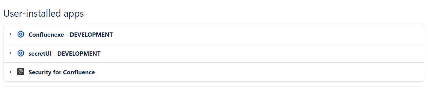

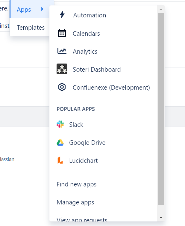

I have followed the official documentation for deploying a project in Confluence and successfully completed the deployment process. The project name appears correctly in the "Manage Apps" section. However, the app is not visible in the main app section where it is usually displayed.

I have double-checked the configuration and permissions but have not been able to resolve this issue. I would appreciate any guidance or suggestions on what might be causing this problem and how to ensure that the app appears and functions correctly in the main app section.
