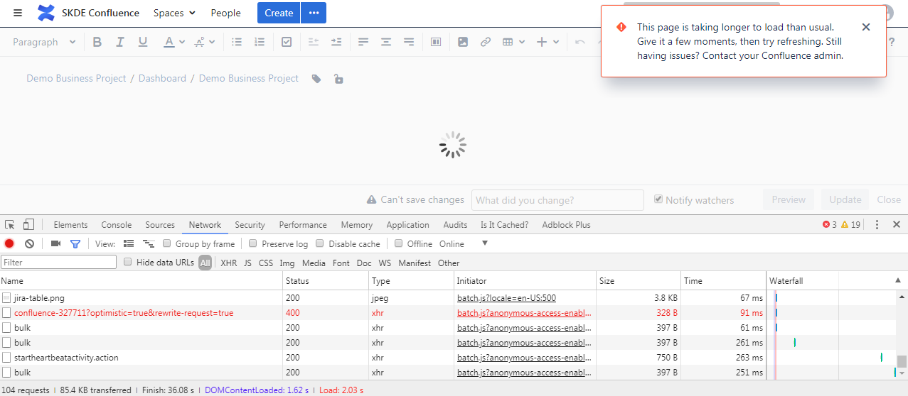

When I try to access "https://example.com/confluence", I can access Confluence as usual.
When I try to edit a page, I get the following error:
This page is taking longer to load than usual. Give it a few moments, then try refreshing. Still having issues? Contact your Confluence admin.
As you can see ("confluence-327711"), there is a faulty (Status/Error Code 400) AJAX call to the "/synchrony" location.
When I open that call in a new browser tab, I will receive the following JSON error:
{"type":"missing-token","message":"Missing token"}
The error mentioned above is misleading! Here is the correct error... When opened within a new tab, Synchony will always reply with the error message above. The error message below is the correct one captured with Wireshark.
{"type":"server-error","message":"server error","id":"WUeTwdxxQ5UQyVu-tQglYw"}
