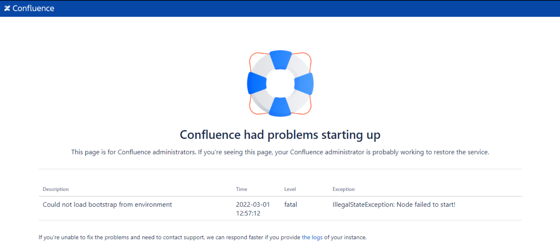

I'm trying to add a node to my Confluence data center instance and it's not working.
It shows me the following error screen every time I start the second node:
I've configured the second node with the steps that it puts in the Atlassian documentation, but the same thins happens constantly.
Both nodes see each other and have the correct ports open for hazelcast.
I show you a log trace:
