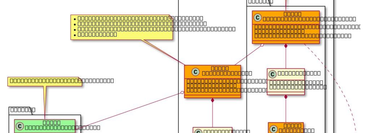

When inserting an SVG image into a Confluence page, the SVG preview and view in the editor look OK. However, on a subsequent *reload* of the page, the image comes out garbled. It seems like Confluence is replacing the SVG (crisp and small vector graphics) with a JPEG image (pixelated, compression artifacts in scaling, larger in size).
I suppose the image converter used does not know how to handle fonts correctly (in this case `font-family="sans-serif"`), and replaces text glyphs with boxes/squares (see image).
