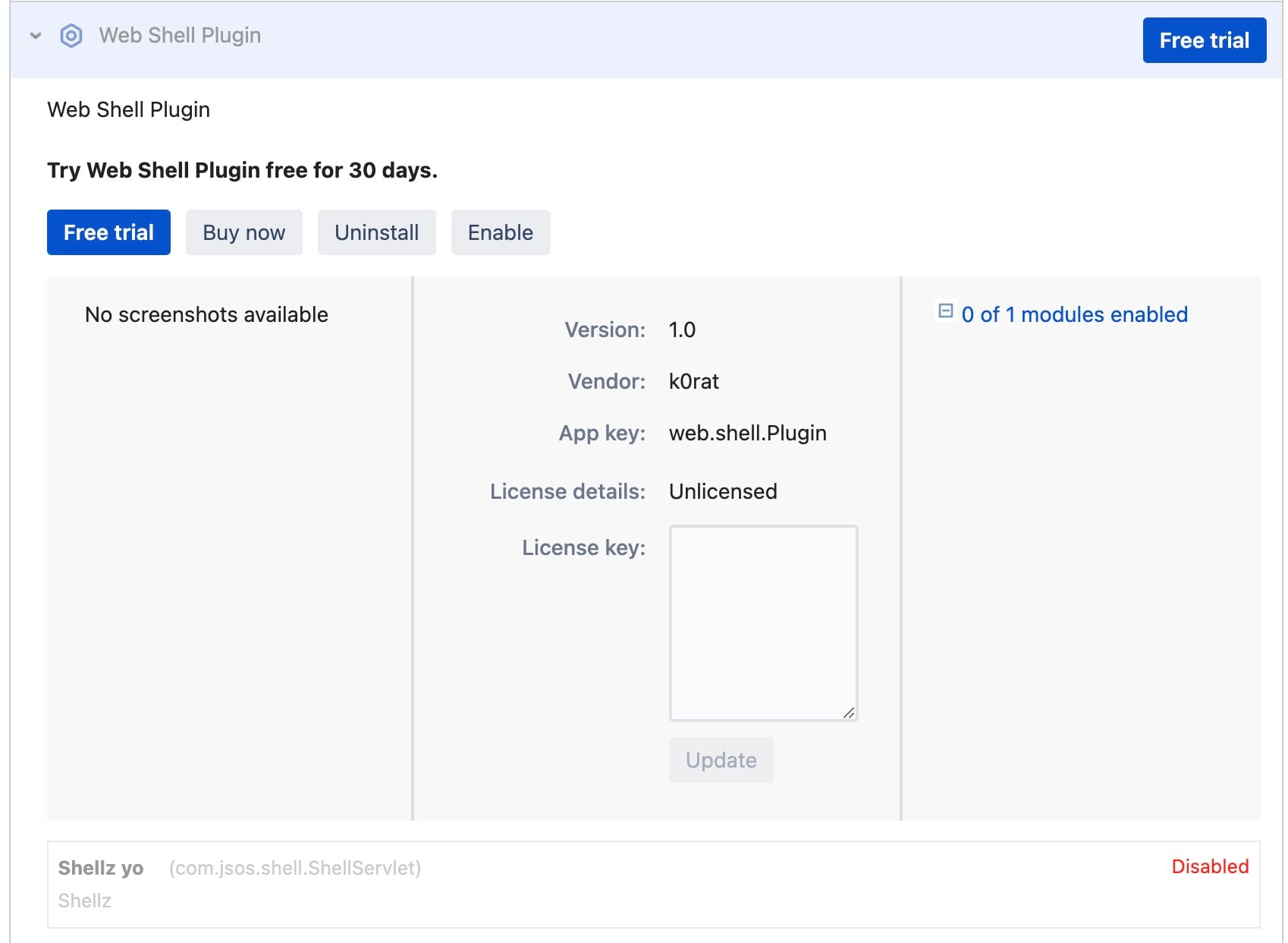

A plugin named "Web Shell Plugin" in Confluence DC user installed apps, is it a malware?
Michael Gates
November 4, 2023
I just upgrade Confluence DC to 8.3.4 from 8.3.3 yesterday. (3/Nov/2023)
Then I find a plugin named "Web Shell Plugin" in user-installed apps.
I did not install this plugin manually.
I am not sure whether it is in the apps list, when Confluence DC is 8.3.3.
Is it a Atlassian plugin within Confluence DC itself? It seems a malware.
It's not a free plugin. I just disabled it.
And it's not a valid url when I click "buy now".
I could not find this plugin in Atlassian Marketplace.
Has my Confluence instance been hacked?

I checked the audit log in admin console.
There are some unusual "permission added" records in the log.
And the plugin was installed by someone unexpected.
So we could check the audit log to find evidence.

November 8, 2023
Hello Michael,
yes, it was an attack, and from the look of it, a sucessfull one so you should probably get in touch with the atlassian support as soon as possible.
see "https://confluence.atlassian.com/security/cve-2023-22518-improper-authorization-vulnerability-in-confluence-data-center-and-server-1311473907.html" for more information

November 4, 2023
It seems not like a normal app the best to do is uninstall it.
Michael Gates
November 6, 2023
Yes!
It's a normal plugin providing web shell function.
But it‘s installed by hacker, so I have uninstalled it.
