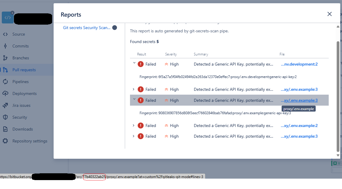

The pipeline finds and annotates the two findings (amongst others) in a report, see the two findings expanded below, however, the file URL points to the wrong commit (see bottom-left in attached screenshot)
As-is behavior:
- file links to current commit. The linked line of code is completely out of date. See below example, pointing to and highlighting (in yellow) an empty line of code.
Expected behavior:
- Preferably the file URL links to the correct line of code in the correct commit.
- If not possible, remove the fie URL and clearly add commit hash in the report, so user can find it themselves.
Unfortunately, this is a pretty serious issue, because in practice many leaks are not found in the latest commit and the findings are confusing to users.

Currently under file section in annotation is the same string you could see in the gitleaks report annotation. Your example from gitleaks:
Finding:     AUTH_CLIENT_ID=xxx
File:        proxy/.env.development
Bu the UI in the Bitbucket Pipelines redirect to the source file by path provided by pipe git-secrets-scan.
We could try to update this path with commit, so you will have the ability to click and go to the problem file.
