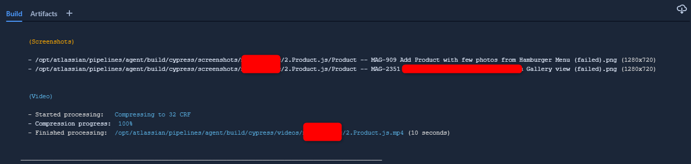

Can you post the log output for a build using the configuration I provided? We can use that to debug further.
I tried as you wrote. When every pipeline (tests) failed then I always got this message:
What I'd like to do is to see screenshots when something went wrong.
Artifacts tab is still blank

I tried change artifact's path to many different options, but nothing helps. Here is an example of 'Build teardown':
