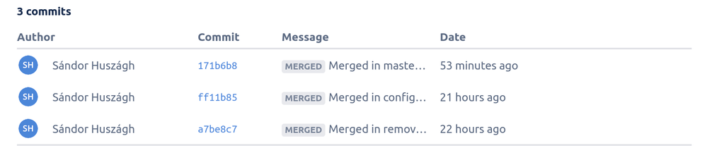

Hi @Caroline R,
At our company, we are experiencing the exact same problem for some months now. Our process is comparable to what @Ali described:
I'm too experiencing the same issues lately on BB Cloud.
Let's assume we have the following branches:
Now A is created from D. a PR is created for Feature A which is then merged onto T.
B is started from D but is dependant of A, so A is merged into B. 1 commit is then done afterwards and a new PR is created of B. All the Changes from A are now shown in the Diff of the PR as well whereas those changes are actually already on T.
This process has been used quite a while now but seems to give these issues as of lately regarding PR diffs. This is just a simple example of a real case but we're seeing more Diffs being added up with old commits actually already merged from AND to different branches. Some diffs were even showing around 40 - 50 lines of commits where 1 or 2 commits were actually applied making the PR system unusable.
It is as somehow the PR mechanics or merging strategy have been changed as of lately and i couldn't point out the issue yet.
the latest situation of the above case has been worked around creating the B branch of from A instead of branching of from D and merging A afterwards. This resulted in the exact same commit hashes with only the missing merge commit (obviously) so i have no clue why that helped.
Hi. I asked a new question about it, and I received an answer. To improve performance, Bitbucket switched from a "3-way" diff to a 2-way "three-dot" diff (see blog here). To remove these extra commits, you must first sync the target branch before submitting the pull request. It is extra work, but there is nothing else you can do
