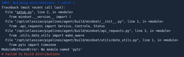

I'm trying to publish a python package but build fails on pipe
My package requires requests and pytz so, on setup.py I have install_requires=['requests', 'pytz']
The atlassian/pypi-publish:0.3.1 image can't find pytz module so, how I can handle this?

Hey @Halyna Berezovska thanks for the reply but it will not help.
I already following this exactly Python Package guide and have the DISTRIBUTION set on my bitbucket-pipelines.yml. Using a python venv without pytz, the behavior is the same when I ran "python setup.py " ModuleNotFoundError: No module named 'pytz'
Since pytz and requests are needed, I need to install it on pypi-publish before pipe.py run.

diego.magalhaes November 16, 2020
@Halyna Berezovska
I found a way to solve this problem before your reply. The pipe was removed from yaml and I used twine to upload and it directly so:
script:
export BUILD_VERSION=${BITBUCKET_TAG}
- pip install twine requests pytz
- python setup.py sdist bdist_wheel
- twine check dist/*
- twine upload -u ${PYPI_USERNAME} -p ${PYPI_PASSWORD} dist/*
 Thank's for your support!
