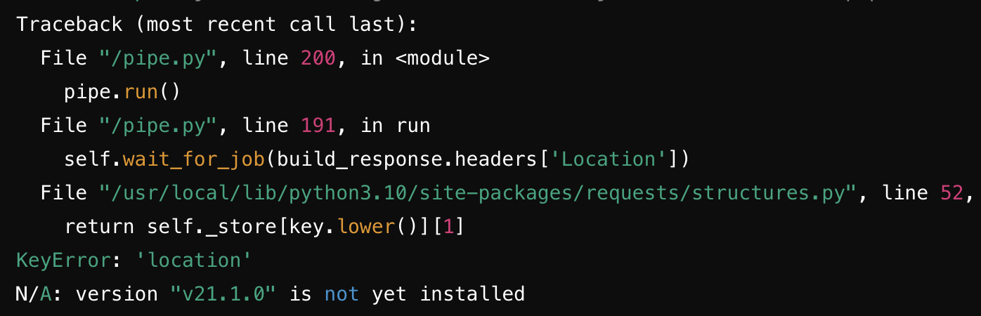

I’m encountering an issue while triggering a Jenkins multi-branch pipeline from a Bitbucket Cloud pipeline using the atlassian/jenkins-job-trigger pipe. The pipeline fails with a KeyError: 'Location' when attempting to retrieve the Location header from the Jenkins API response. Below are the detailed logs, pipeline configuration, and troubleshooting steps I have tried so far.

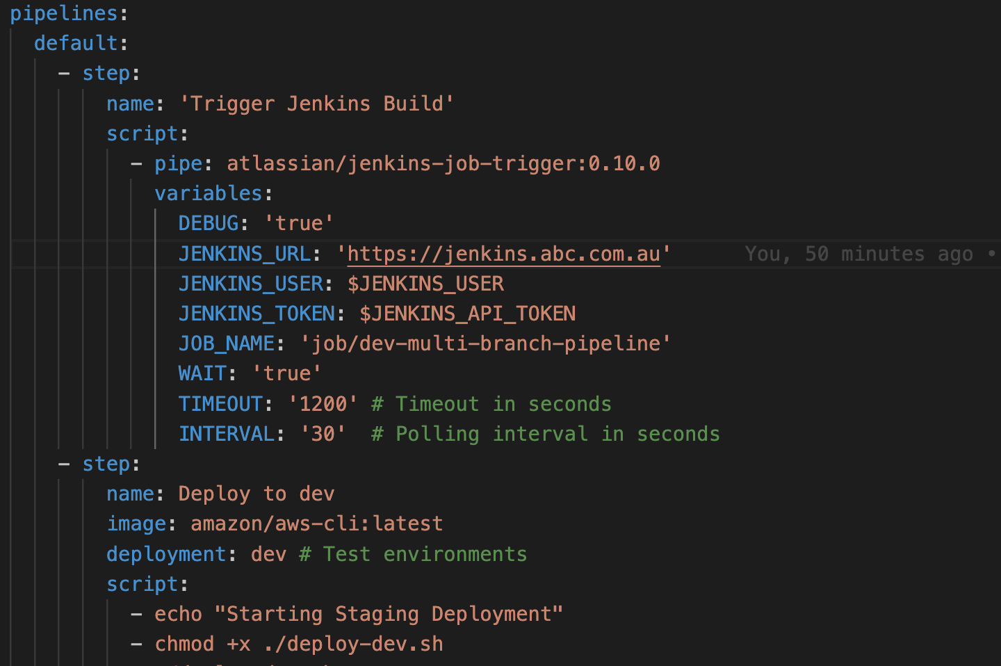

Pipeline Script
Below are the detailed logs captured during the pipeline execution:
INFO: None INFO: Submitting jenkins job... DEBUG: Starting new HTTPS connection (1): jenkins.abccompany.com.au:443 DEBUG: https://jenkins.abccompany.com.au:443 "POST /job/dev-multi-branch-pipeline/build HTTP/11" 302 0 DEBUG: https://jenkins.company.com.au:443 "GET /job/dev-multi-branch-pipeline/ HTTP/11" 200 None Traceback (most recent call last): File "/pipe.py", line 200, in <module> pipe.run() File "/pipe.py", line 191, in run self.wait_for_job(build_response.headers['Location']) File "/usr/local/lib/python3.10/site-packages/requests/structures.py", line 52, in __getitem__ return self._store[key.lower()][1] KeyError: 'location' N/A: version "v21.1.0" is not yet installed
atlassian/jenkins-job-trigger pipe expects a Location header in the response from Jenkins, but this header is missing. The pipe fails when attempting to access build_response.headers['Location'].Location header pointing to the queue item or build status URL after the job is triggered.Location header, the Jenkins API responds with an HTTP 302 redirect to the job URL and no further details.

@Patrik SI identified and fixed an issue in the Bitbucket pipeline script where the JOB_NAME prefix was incorrect.
Incorrect Format:JOB_NAME: "job/dev-multi-branch-pipeline/"
Correct Format:JOB_NAME: "job/dev-multi-branch-pipeline/job/$BITBUCKET_BRANCH"
