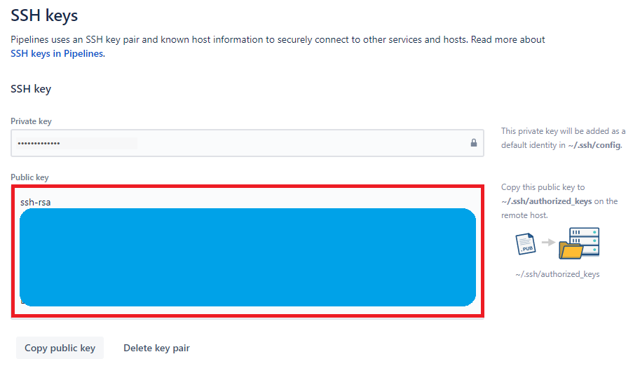

I am struggling with SSH I think. I followed this : https://support.atlassian.com/bitbucket-cloud/docs/variables-and-secrets/ and it's not working.
So basically, I did:
Step 1: Add an SSH key in Bitbucket
Step 2: Update the known hosts

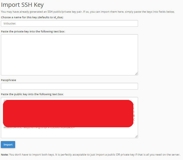

Step 3: Add the public key to a remote host
So I copied/pasted the Public key displayed in step 1 (inside the red rectangle)
I also authorized the key :

By the way, step 3 also seem strange to me, when you copy somewhere your public key to be authorized, you should not have there private ssh key and its passphrase, because private ssh key is stored only at the location to be authorized, not the issuer. This is the goal of private key. Please, explain more, what you do in Step 3, if you have already generated private and public keys at step 1.
