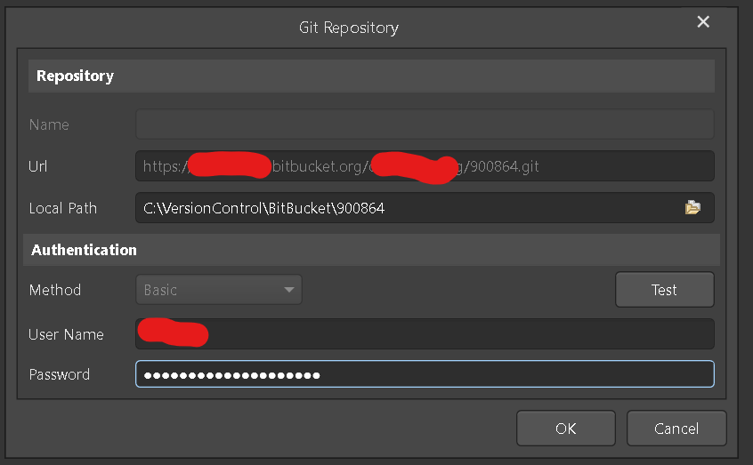

I'm having difficulty with this too. I have an app password and I can push to bitbucket from tortoisegit, but not from within Altium. Do you see anything I have wrong?

It failed again. This time with an all-permissions app password and my username.
This is the path to the source files:https://bitbucket.org/xxxxx/900831/src/master/
Where do I find the log files? I wasn't able to find one for Altium, but maybe there is one somewhere.
here is the test button output:

From your tests the credentials does not seem to be the issue here, and the fact that you are able to successfully clone/push from tortoiuse git indicates the issue is mostly likely with the configuration of Altium.
Checking the screenshot you attached though, it seems like you Altium configuration is considering the repository as SVN, instead of git, and this might be causing the error. This is also reinforced by the fact the error message when you clicked "Test" is not complaining about authentication but with the address of your repository.
As this is a third-party application, I don't really have much knowledge on how it's configured other than what I could find in Altium's documentation, so in this case I would suggest looking for any setting in the screen that you shared that allows to change the repository from SVN to Git.
If it does not work, I would recommend following the steps outlined on Altium's official documentation of how to integrate with a git repository.
