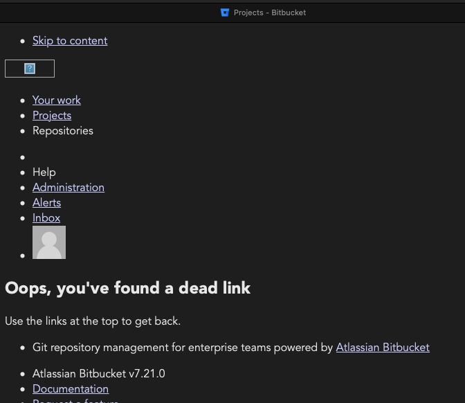

Installed Bitbucket 7.21 on Ubuntu 20.04. Everything works when I directly connect to http://bitbucket.myserver.mytld:7990.
I configured Apache2 reverse proxy and now none of the CSS, img, and JS resources are found, I simply get the plain unadorned html. That indicates that the bitbucket server IS being accessed through the proxy, just none of the resources are there. Comparing the <img src=... and other resource paths with the WebInspector shows that they are identical between a page directly accessed vs. the same page accessed through the proxy.

What am I missing?
