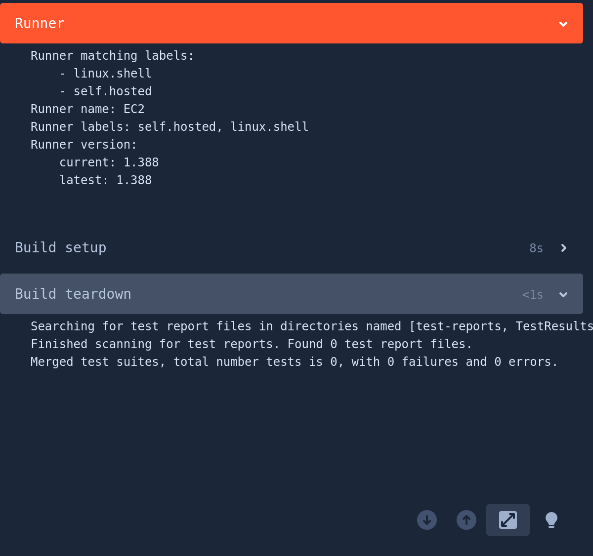

I would like my Bitbucket runner to run as a cron job on boot. The command provided by Bitbucket to launch the runner manually works as intended, but as soon as I try to launch it from a cron job (or a from a service), I get the following in the runner's log :
[2022-12-24 12:51:49,999] Executing build script in native script.
[2022-12-24 12:51:50,047] Script exited with exit code: 1
This results in the pipeline failing completely, with the following output on Bitbucket :
I am using the Linux runner on an Ubuntu 20.04.5 instance hosted on AWS.

I tried taking a look at the build log (/opt/atlassian-bitbucket-pipelines-runner/temp/7d1b991d-4db7-51d4-a743-f670097fc201/tmp/build14160541035342645415.log), but I wasn't able to because the file didn't exist.
I'd really appreciate a bit of help for this
