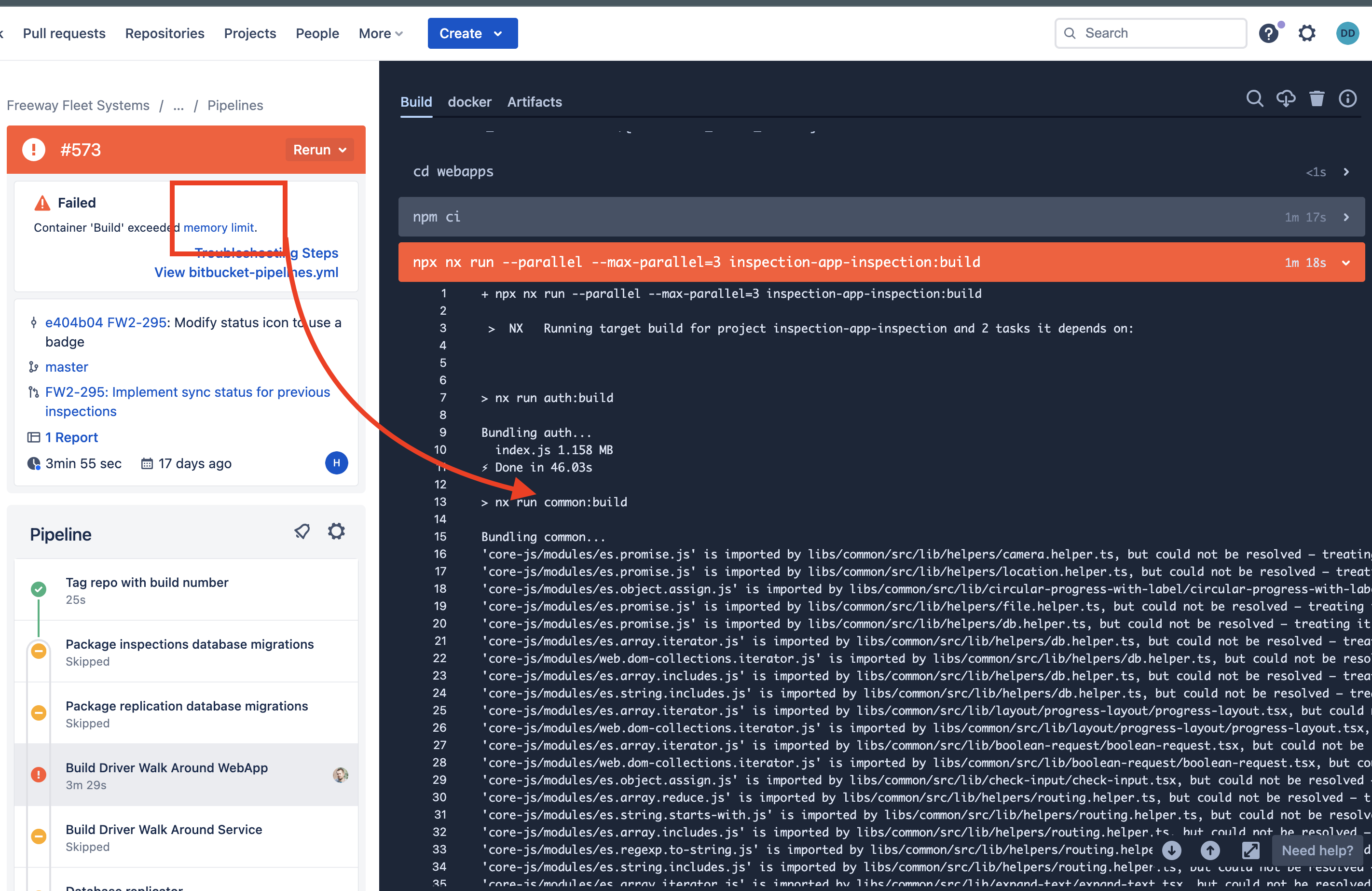

Problem is the memory limit during client side app build step in pipelines
The problem located in front end module - common lib

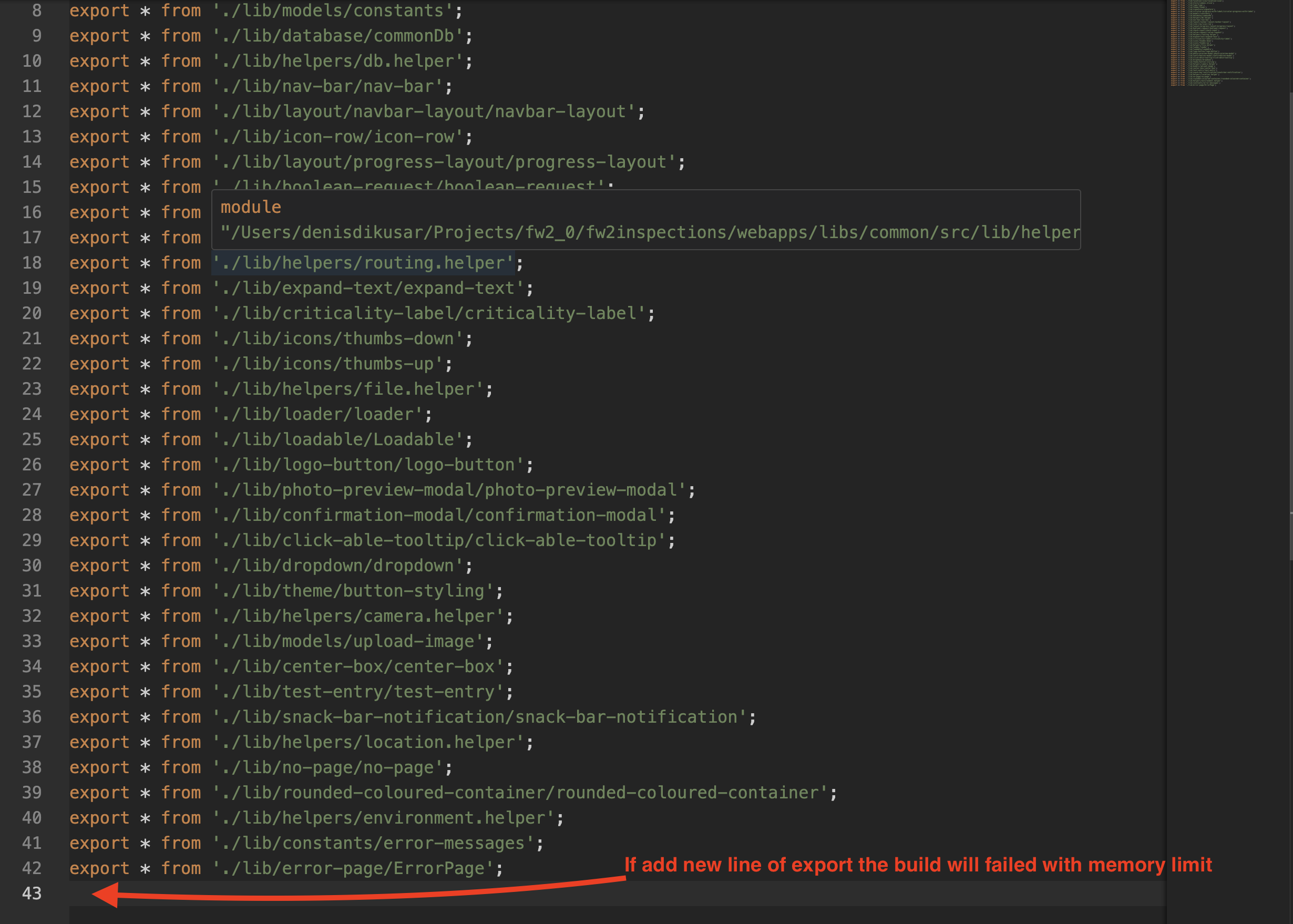

We solved the problem by removing new export from the lib - it is 43 line of export.
common/src/index.tsx now has 42 line of code and every line it's a export of smaller module
Before we figure out it, we tried to increase memory limit, but we were understand that the reason in source code, not in memory limit, at the same time after increase memory limit the build were failed.
