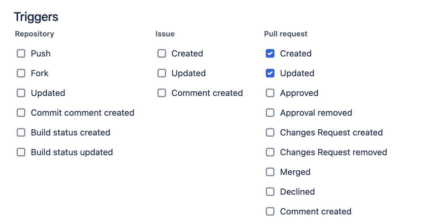

Hi, I'm facing something similar right now, I've configured my webhooks for just Triggers: pullrequest:created, pullrequest:updated.
Anyway, it works when a PR has been created but nothing happens when I push something new on the existing PR (no build are triggered).

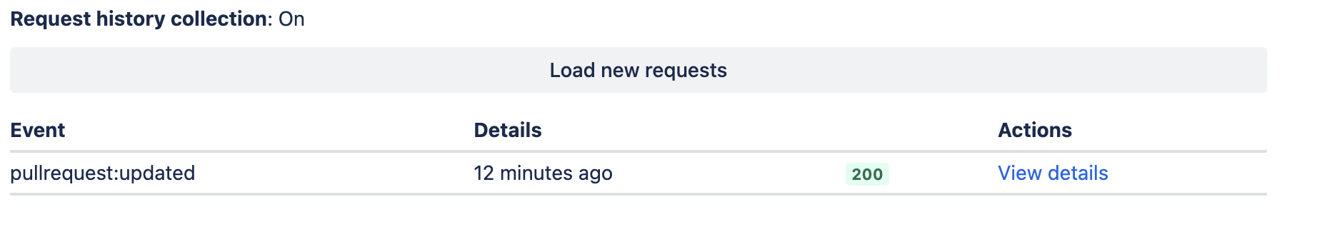

Even enabling request History collection, I can see the event triggered, but then no new builds are starting on my PR.
Am i missing something? I don't want repository:push trigger since the build just needs to start when a PR exists.

The event in your screenshot with a status code 200 indicates that Bitbucket successfully sent the request to the webhook URL. Otherwise, you would see a 4xx or 5xx status code.
If your builds are not triggered, I suggest looking at what happens when your server receives the request. If you're integrating with a third-party CI/CD tool, something may not be configured correctly within this tool. You could reach out to the support team or a forum for this product to help you understand if something is misconfigured. If you have written a script that runs when the request is sent, look at what the script does when it receives the request for the pullrequest:updated event.
