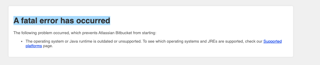

Upgrading Bitbucket server from 5.0.1 to 7.5.0. All was going well pretty much til I went to start up the new version.
Upgraded Java from 8 to 11:
-bash-4.2$ java -version
openjdk version "11.0.8" 2020-07-14 LTS
OpenJDK Runtime Environment 18.9 (build 11.0.8+10-LTS)
OpenJDK 64-Bit Server VM 18.9 (build 11.0.8+10-LTS, mixed mode, sharing)
I have ensured that the set-jre-home.sh script is setting the correct version, and it's pointing at this version, but the UI is displaying this page:
I think this is a bit misleading though, because seem as though the java is fine. I'm on RHEL Linux, but the Supported platforms page doesn't list specific Linux Distributions as supported or not, and the previous version ran fine on this server.
Below are the logs I can see at /var/atlassian/application-data/bitbucket/log/atlassian-bitbucket.log

2020-08-31 18:10:17,422 ERROR [spring-startup] c.a.j.s.w.s.JohnsonDispatcherServlet SpringMVC dispatcher [springMvc] could not be started
org.springframework.beans.factory.UnsatisfiedDependencyException: Error creating bean with name 'packObjectsHookHandler' defined in URL [jar:file:/opt/atlassian/bitbucket/7.5.0/app/WEB-INF/lib/bitbucket-git-7.5.0.jar!/com/atlassian/stash/internal/scm/git/hook/handler/CachingPackObjectsHookHandler.class]: Unsatisfied dependency expressed through constructor parameter 2; nested exception is org.springframework.beans.factory.UnsatisfiedDependencyException: Error creating bean with name 'gitCommandBuilderFactory' defined in com.atlassian.stash.internal.scm.git.GitWiring: Unsatisfied dependency expressed through method 'gitCommandBuilderFactory' parameter 0; nested exception is org.springframework.beans.factory.UnsatisfiedDependencyException: Error creating bean with name 'gitCommandCreator' defined in com.atlassian.stash.internal.scm.git.GitWiring$NioWiring: Unsatisfied dependency expressed through method 'gitCommandCreator' parameter 0; nested exception is org.springframework.beans.factory.BeanCreationException: Error creating bean with name 'nioProcessHelper' defined in class path resource [stash-context.xml]: Invocation of init method failed; nested exception is com.atlassian.bitbucket.internal.process.NioUnsupportedException: Failed to initialize NIO

Caused by: org.springframework.beans.factory.BeanCreationException: Error creating bean with name 'nioProcessHelper' defined in class path resource [stash-context.xml]: Invocation of init method failed; nested exception is com.atlassian.bitbucket.internal.process.NioUnsupportedException: Failed to initialize NIO
at org.springframework.beans.factory.support.AbstractAutowireCapableBeanFactory.initializeBean(AbstractAutowireCapableBeanFactory.java:1796)
... 5 common frames omitted
Caused by: com.atlassian.bitbucket.internal.process.NioUnsupportedException: Failed to initialize NIO

Caused by: java.lang.UnsatisfiedLinkError: /var/atlassian/application-data/bitbucket/tmp/jna17154694746383231096.tmp: /var/atlassian/application-data/bitbucket/tmp/jna17154694746383231096.tmp: failed to map segment from shared object: Operation not permitted
