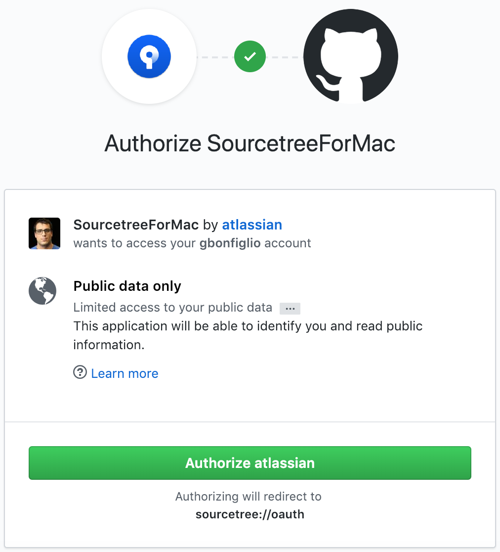

I spotted the below (see screenshot) during login (which is clearly some recent regression since my old token was probably ok) - why is SourceTree asking for readonly access to my GitHub account and then using it to push code?
In short, HTTP doesn't work for this reason, SSH doesn't work for another reason. Is someone looking into this? I'm surprised there are still so many topics on login issues, sounds like something hard to get right?

Anyway, I'd prefer to have oAuth fixed given ST requires it anyway to list repos etc. Is the one I'm facing a bug?
Giorgio
Could you please submit a ticket on http://jira.atlassian.com/ for the team to look into this? We haven't had reports of this after moving the OAuth to default browser.
