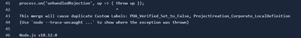

Attempting to fail a pipeline conditionally from within a node.js script called from bash
As part of an automated pipeline, I'd like to run some data quality checks on the files being merged. To do this, I'm running a node.js script. If data quality constraints aren't met, I'd like to fail the pipeline with a message.
I've tried every suggested option in the following stack exchange article, but none are working: How do I fail a script running in Bitbucket Pipelines?
I can see in the output from the Pipeline that the exception is being thrown:
However, the pipeline is just carrying on to the next line in the bash script, rather than failing with the message that has been set.

@Erez Maadani - Thank you for your help so far. Unfortunately - that's not working.
Whatever I'm doing (I've tried multiple approaches), the exit code is always 0. I've thrown an exception, caught the exception and then used process.exit, the result is still a zero exit code.
My latest version is as follows
I've tried multiple variations of the code, but whatever happens, I get a zero exit code. As you can see, I've attempted to call process.exit() within the logic in the first screenshot (I commented out the "throw" line), I've also tried making the process async and not async, in case that makes a difference. The differences tend to be that the custom thrown exception will or won't be shown in the output from the pipeline, but the exit code is always the same.

Hey @Erez Maadani - I got this working. There were a couple of things wrong with my code, a few of which I was able to resolve with your help:
  • The "echo exit code" row was preventing me from capturing the exit code from the JS
  • I hadn't properly imported the process module, so my process.on() method wasn't firing properly
Once I'd resolved those two, I no longer had to use process.exit(), as throwing the exception within the process.on() method implicitly set the exit code to 1 (and I also see the exception method in the log)
The if statement in your response was helpful, didn't work for me. I think it had too many speech marks in it, as it caused an error at runtime. However, it did point me in the right direction and I was able to adapt it slightly to make it work for me:
With these in place, I was now able to throw an exception, so that the Pipeline will fail and the error message is available in the log for the pipeline. Thank you.
