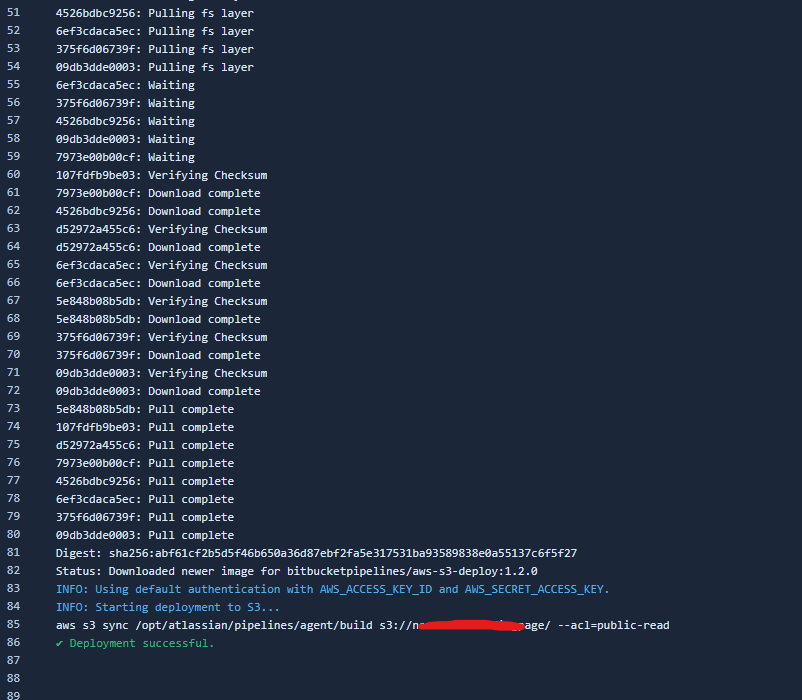

Hello everyone, i need help about this issue.
i got a situation when usiong aws s3 deploy,
the pipeline build was successfull, the log can see bellow
But when i check the S3 Bucket, there is nothing. the bucket are still empy
Whats wrong, do i missing something?
and this is my Bitbucket pipelines,
my apps using Vue/Nuxt3 to be deploy on S3 and Cloud front, this is the full pipelines yml

Try adding the DEBUG variable to get more info. You can also try and add the PRE_EXECUTION_SCRIPT to list the files in your `pwd` and make sure they exist where you think they should.
Have a look here: https://bitbucket.org/atlassian/aws-s3-deploy/src/master/ for more details.
@Amirull Yusuf Zulkarnain hi.
To update previous answer.
Seems like the folder that you want to upload is empty.
Maybe you need to upload with artifacts.
Check this article for more info.
Regards, Igor
