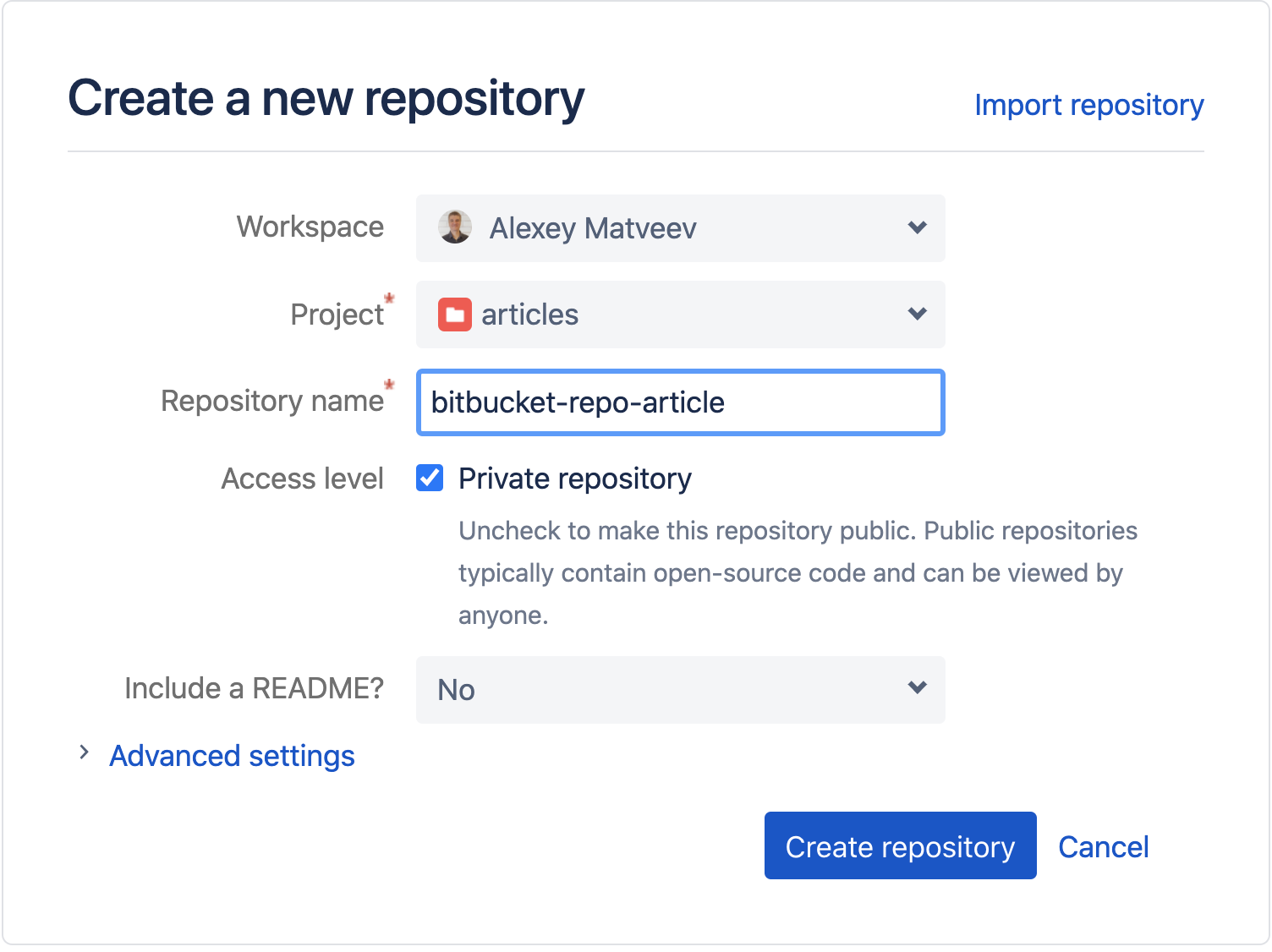

Create a Bitbucket repo
First I will create a Bitbucket repository:

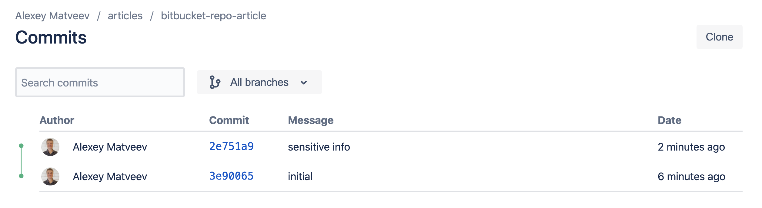

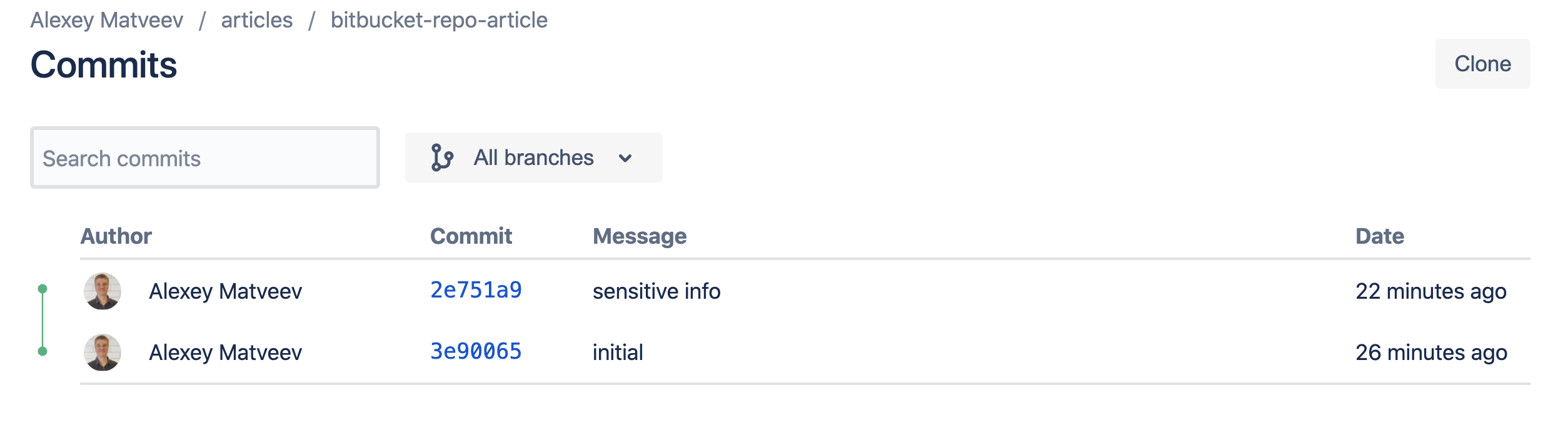

If we have a look at our Bitbucket now we will see two commits:

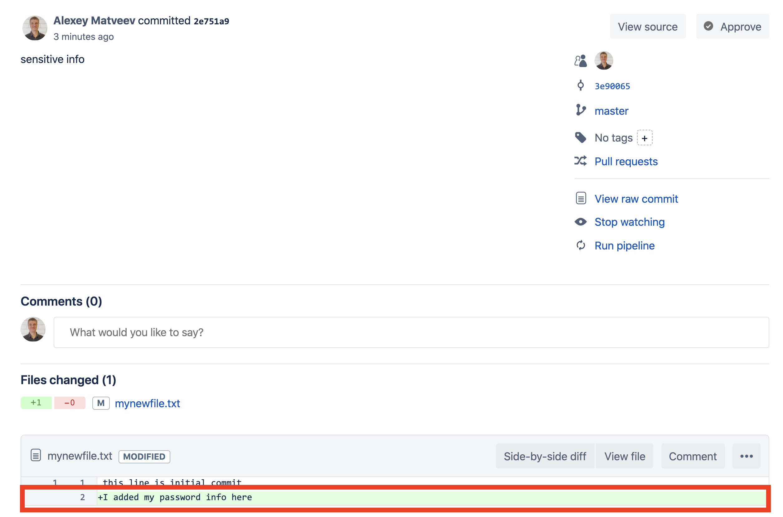

And our commit with sensitive information contains our password line:

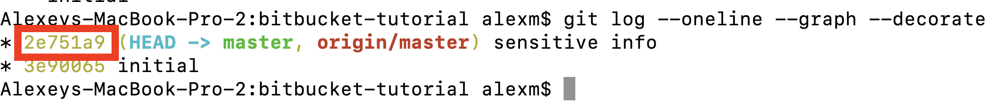

Let's first find the id of our commit:
git log --oneline --graph --decorate
Here is the output:
I marked the id of our commit with a red rectangle.

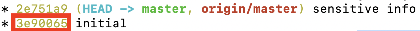

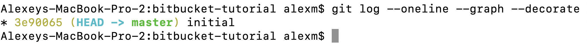

Now let's remove this commit. We need to reset our git repository to the commit which took place before our wrong commit. The id of the previous comment is 3e90065:
Now let's reset our repository
git reset --hard 3e90065

Our commit history looks like this:
We do not have our comment with sensitive information. Also correct!
But if we look at our Bitbucket repository, we still have our sensitive info comment:

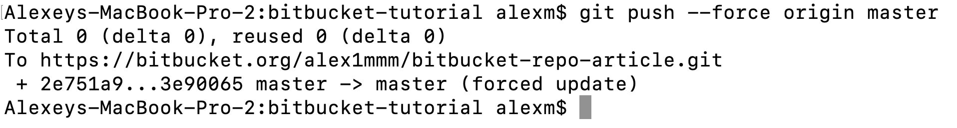

That is because we did not push our changes form our local repository to our Bitbucket repository. Let's do it:
git push --force origin master

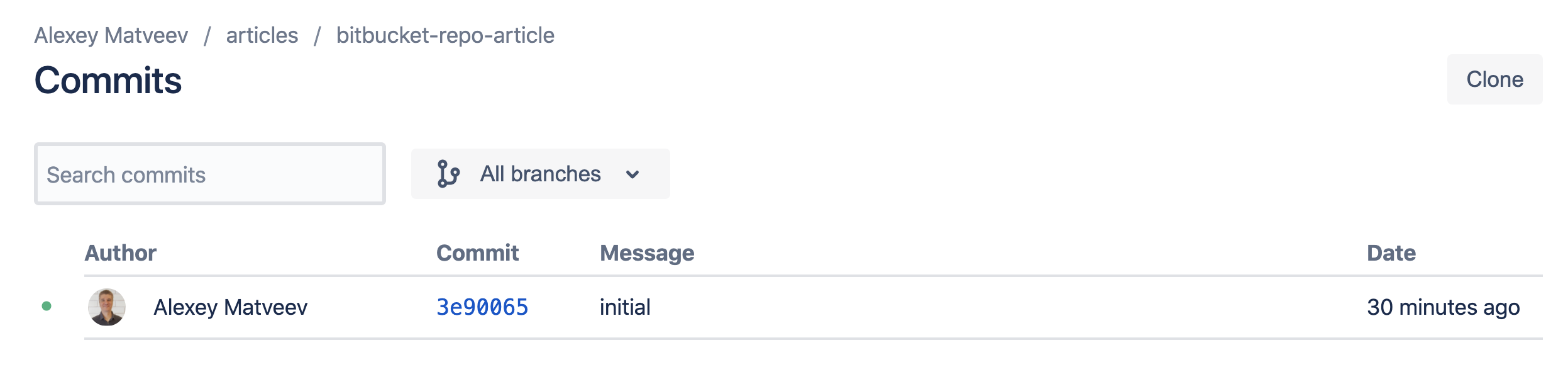

And now if you have a look at our repository in Bitbucket we will have only our initial commit:
Success! We removed the commit with our password from our Bitbucket repository.
