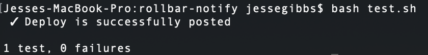

bats test/test.batsA successful run of the test locally would result in the following output:

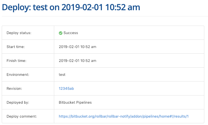

The new deploy could be viewed at https://rollbar.com/Rollbar/bitbucket-pipe-test/deploys/?environments=test.

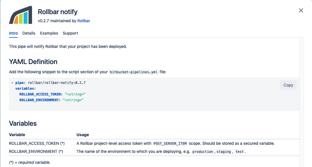

The CI scripts included in the repo (also provided by Atlassian) handle pushing a new docker image to your Docker Hub (you can view ours here) and tagging the git repository to reflect the release. The scripts automatically update the pipe.yml metadata file and the readme.md so they reflect the semantic version of the new release:
With the helpful tools provided by Atlassian as well as open source projects like Docker and Bats, it's extremely easy to build, release, and support a Bitbucket Pipe. If your team is building tools that can integrate into a continuous deployment pipeline, definitely consider building a Bitbucket Pipe!
