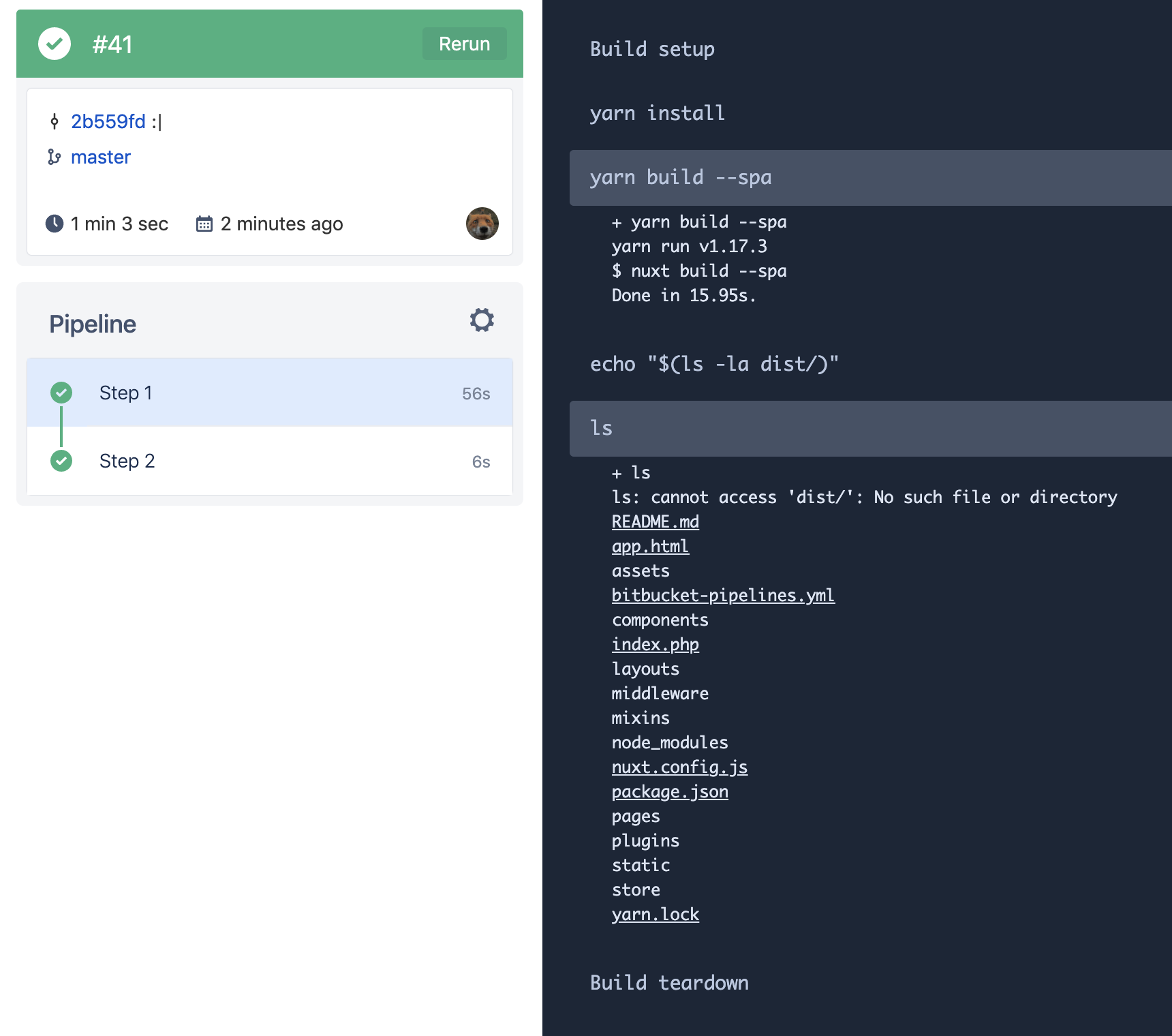

And It is simplest as possible. It's installing all dependencies (yarn install) and using nuxt command yarn build --spa.
Yarn build --spa command is creating new dist folder and putting there build files. If dist folder were already existing script removes that folder and creates new dist folder. If I run this commands on my local machine I'm getting new dist folder filled with build files.
Whole steps are working fine, build step also, but finally there isn't any dist folder.

Already added the artifacts and validate the .yml file. But the pipeline fails because no dist folder is created after build step and not shown at this console output:
- echo "$(ls -la dist/)"
- l
Any suggestion why dist/ is not created at build step in the pipeline? Locally everything works.
Screenshot after output of ls -la:

I'm also using Nuxt. I've been through the same steps. I'm trying to add an artefact, but the `dist` folder is never generated. Like the post above, the `ls -lsa' command shows that no `dist` directory was ever created at the end of the build process.
There's no error in the logs (even with `npm --verbose`), and the entire pipeline completes with an indication of success.
Is this not a bug?
Given @daffodilistic post, it sounds like it could possibly be a RAM issue, but without an error message, it's going to be extremely difficult to recreate that bug, especially on free accounts.
