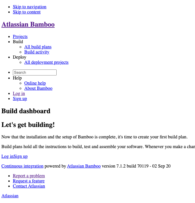

Hello, I have installed Bamboo 7.1.2 using MySQL on a Linux server (Ubuntu 18). The instance is secured behind nginx using SSL. I can access the site and have been able to set it up through the initial wizard.
However, the site is not loading its style and JS scripts, concretely these two: batch.css and batch.js.
Both are not found by the Chrome browser, which shows a 404 (not found) error when it tries to locate the above files from the following paths (BASE_URL should be replaced by the real domain):
BASE_URL/s/22339b840a686a652eda9cb945eaefe7-CDN/70119/1/ae711dd0dea2627fc013ff31d7536b2e/_/download/contextbatch/css/aui,atl.admin,-_super/batch.css?healthcheck-resources=true
BASE_URL/s/4f2a819378a916c3871918a0b64209dc-CDN/70119/1/ae711dd0dea2627fc013ff31d7536b2e/_/download/contextbatch/js/aui,atl.admin,-_super/batch.js?healthcheck-resources=true&locale=en
Without having the above properly loaded, I can barely do anything on the site (see attachment).
Could somebody help me solving this issue, please?
Thanks
