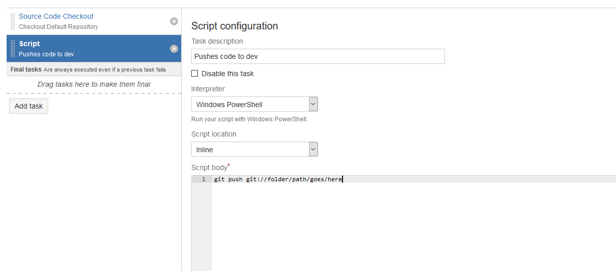

How can I push code to a remote server using bamboo?
I'm running an on prem Bitbucket repo with an on prem Bamboo server.
I'd like to checkout code on commit and then push the changes to a different server automatically.
I'm at a loss for how to get things to function. Here is what I've done so far:
  1. Created repositories and everything is properly pushing and pulling
  2. Connected Bitbucket and Bamboo successfully
  3. Installed git on all of the servers and it works like a charm from command line and gui interfaces
  4. Created a build plan that has 1 job... it checks out the code from the repo
This is where I get stuck. I created a script task that uses a git push command but for some reason, bamboo is not allowing the git command to work. I tried the following:
  • writing the command inline
  • placing it in a batch file
  • I tried including the $ before git and not
  • I tried powershell, shell with a bash shebang, and cmd.exe to no avail
I think I'm missing a crucial component but don't know what I don't know. Any help would be greatly appreciated.
Screens below show the log and how one instance of the command is setup.2018-09-13 08_08_39-Gallery of Guns - GOG Development - Push to dev_ Edit job configuration - Atlass.png2018-09-13 08_09_48-Gallery of Guns - GOG Development - Push to dev 11_ Build log - Atlassian Bamboo.png

Hi @davidsons,
The issue is that Git is not in the path. Please confirm that you can run the git command manually on the server. If not, then check your path.
Hi @edwin
git is in the path already and can be run manually on the server
