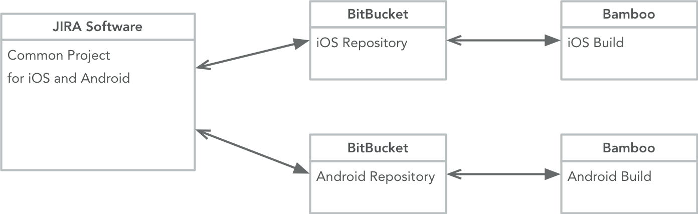

We would like to set up a Continuous Integration pipeline with JIRA, BitBucket and Bamboo with only one server, an 8 cores MacPro:
Is it possible to set this up with only one server, only one BitBucket instance and only one Bamboo instance ?
Or do we have to have a macOS server for iOS and a Linux server for Android, both running Bamboo ?
We would much prefer to have one server (Mac) with only one Bamboo instance.
