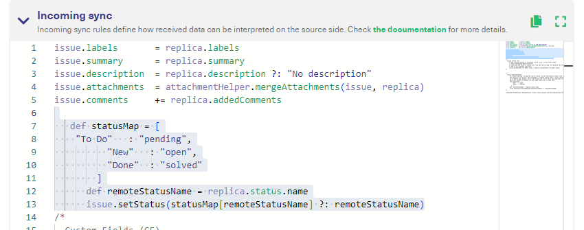

On the Zendesk side, add the following code:
def statusMap = [
    "To Do":"pending",
          "New":"open",
          "Done":"solved"
def remoteStatusName = replica.status.name      issue.setStatus(statusMap[remoteStatusName] ?: remoteStatusName)
Note: The statusMap variable establishes the relationship between statuses. The remoteStatusName maps to the replica’s status. Eg., A “pending” case on Zendesk appears as “To Do” in Jira.
Once done, click “Publish” to save the changes.

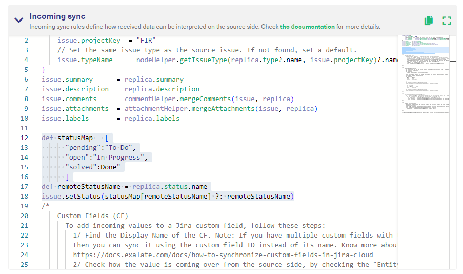

On the Jira side, enter the code in the “Incoming sync” text box.
def statusMap = [
      "pending":"To Do",
      "open":"In Progress",
      "solved":Done"
Note: The statusMap variable establishes the relationship between statuses. The remoteStatusName maps to the replica’s status name. Eg., An “open” ticket on Zendesk appears as “In Progress” in Jira

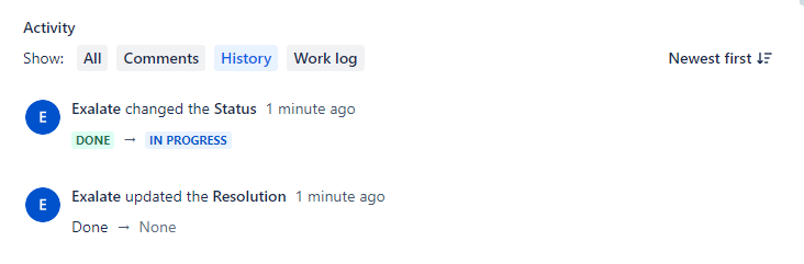

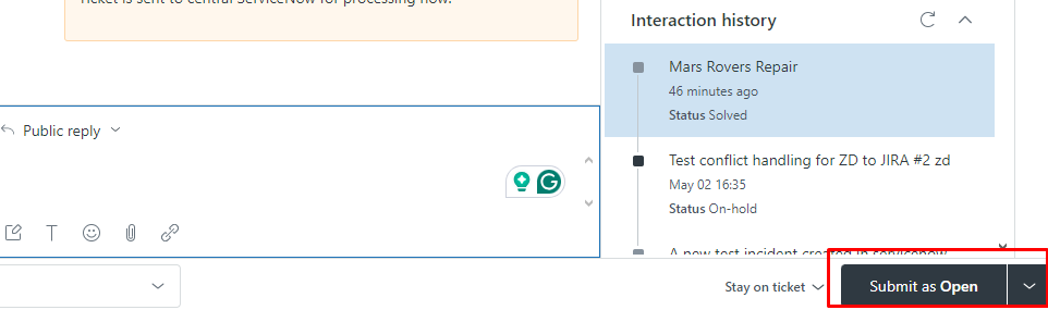

Now go back to the Zendesk ticket and set the status as “Open”.
Back on Jira, you will see the status appear as “In Progress” automatically.
Congratulations! You have now set rules to help you update the status of Jira issues with Zendesk tickets.
