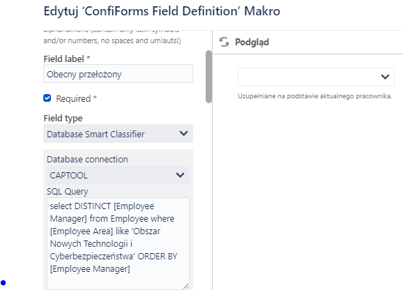

I need some help to filter/narrow down the output from the 'database advance field'.
I tried several ways like 'Applying filter on a field' or using smart classifier but it's still not working as expected.
Let's say I have some workers and I need to assign the proper manager to the given employee. How can I do it?
My sql statemant to retrives all employee (based on selected employee I need to assigne proper manager).
The scond field shoud also be dropdown or auto assigning value.

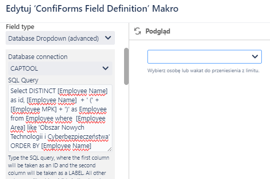

Still dosen't appear in the form and table at all 'ConFiForms Field macro' and not filtering. :/
Here is the set up again:
Alex Medved _ConfiForms_
January 15, 2025
Sorry, what should I be able to read from that picture?
It should be WybierzWakat.managerid, not WybierzWakat.ManagerID
See the description for the database field
Also, take a look at https://wiki.vertuna.com/display/TEST/Database+dropdown+with+extra+fields+in+a+table
It shows how the extra field "link" is accessed...
Same approach I was suggesting for you

Hello @Sahir Maharaj can you tell me more or less how the sql query should looks like inside this smart classifier? How can I refer to another field from the form in such sql query?
And dependent dropdown field is called in this case 'Dynamic dropdown (Database)'?
Here also I should use sql but I don't know how to refer to the existing field and filter based on the earlier entered value.
