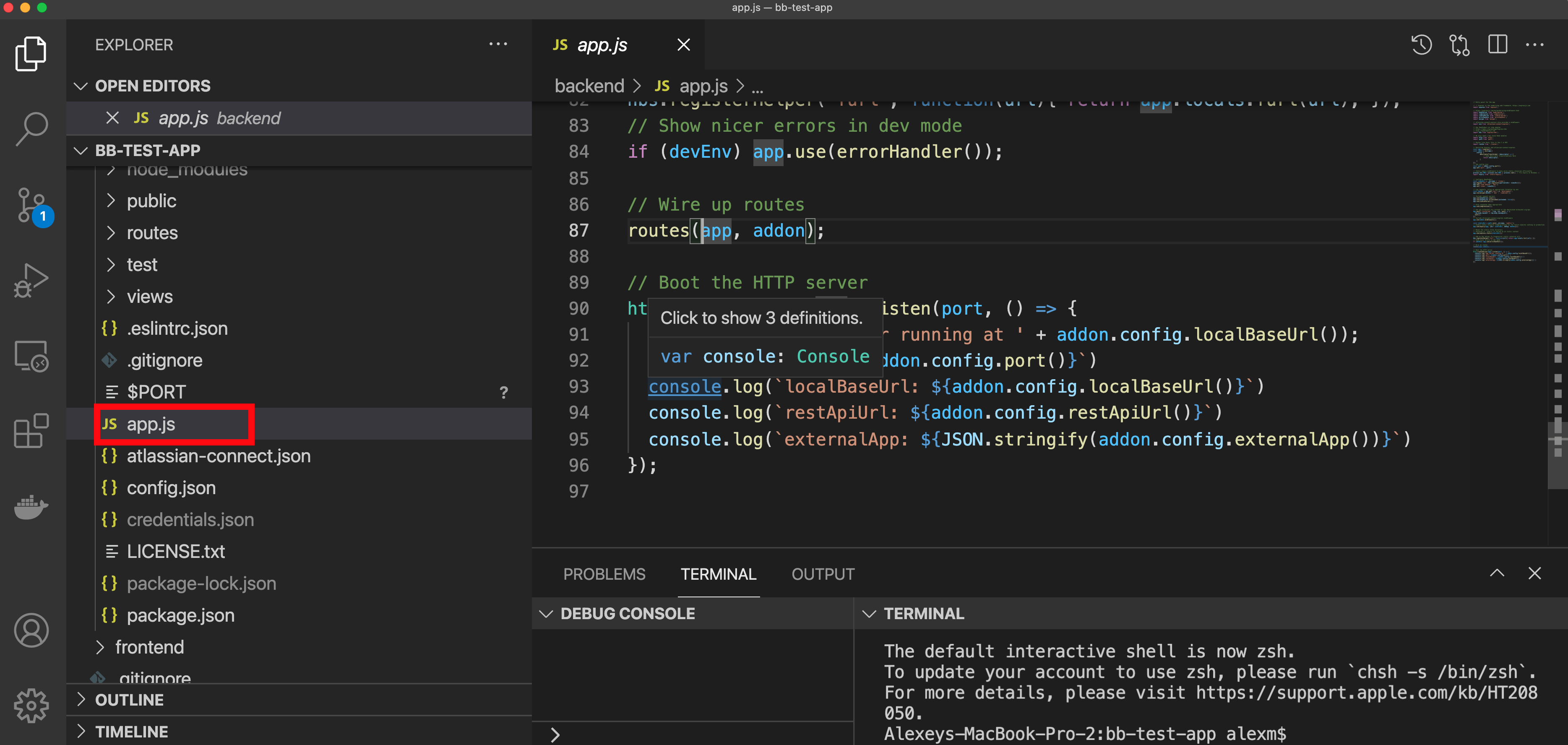

To debug our application in VS code select the backend/app.js file:

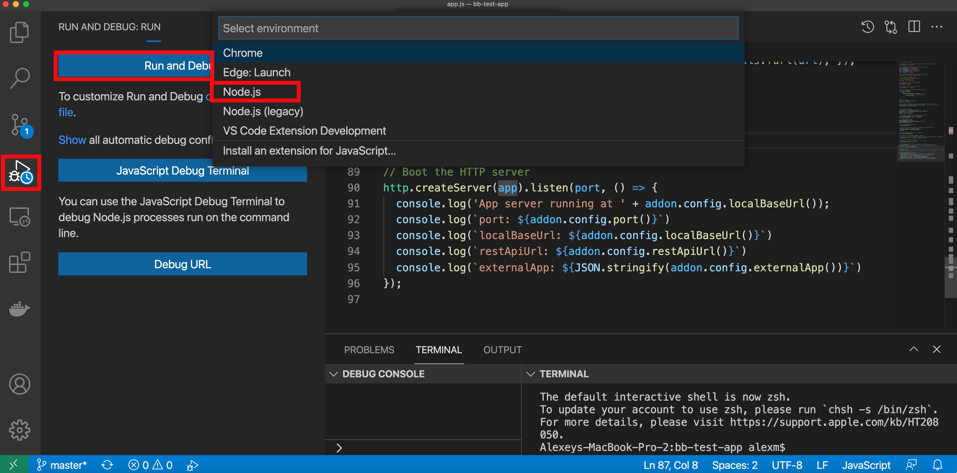

Now open the “RUN AND DEBUG” tab, push the “Run and Debug” button and chose Node.js in the list:
And we have an error:
/usr/local/bin/node ./backend/app.js
Process exited with code 1
(node:1411) Warning: To load an ES module, set "type": "module" in the package.json or use the .mjs extension.
(Use `node --trace-warnings ...` to show where the warning was created)The problem is that when we launch our app we pass the following parameter:
-r esmIt means that we also have to pass this parameter to our debugger.

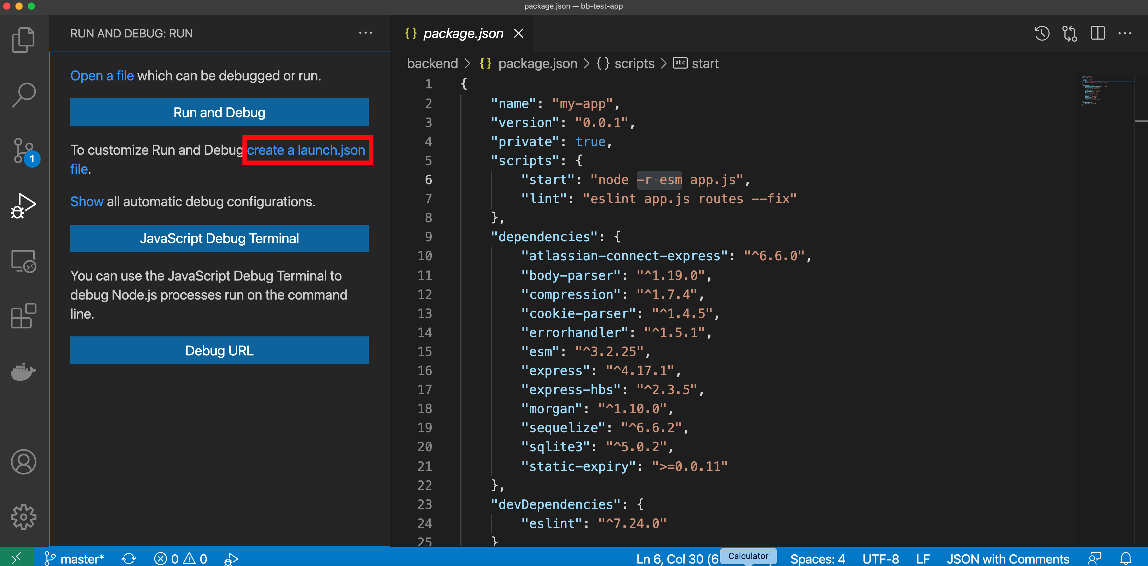

Click on the “create a launch.json file” link (choose Node.js item in the list, which you will see after you clicked the link):
A launch. json file will be created:

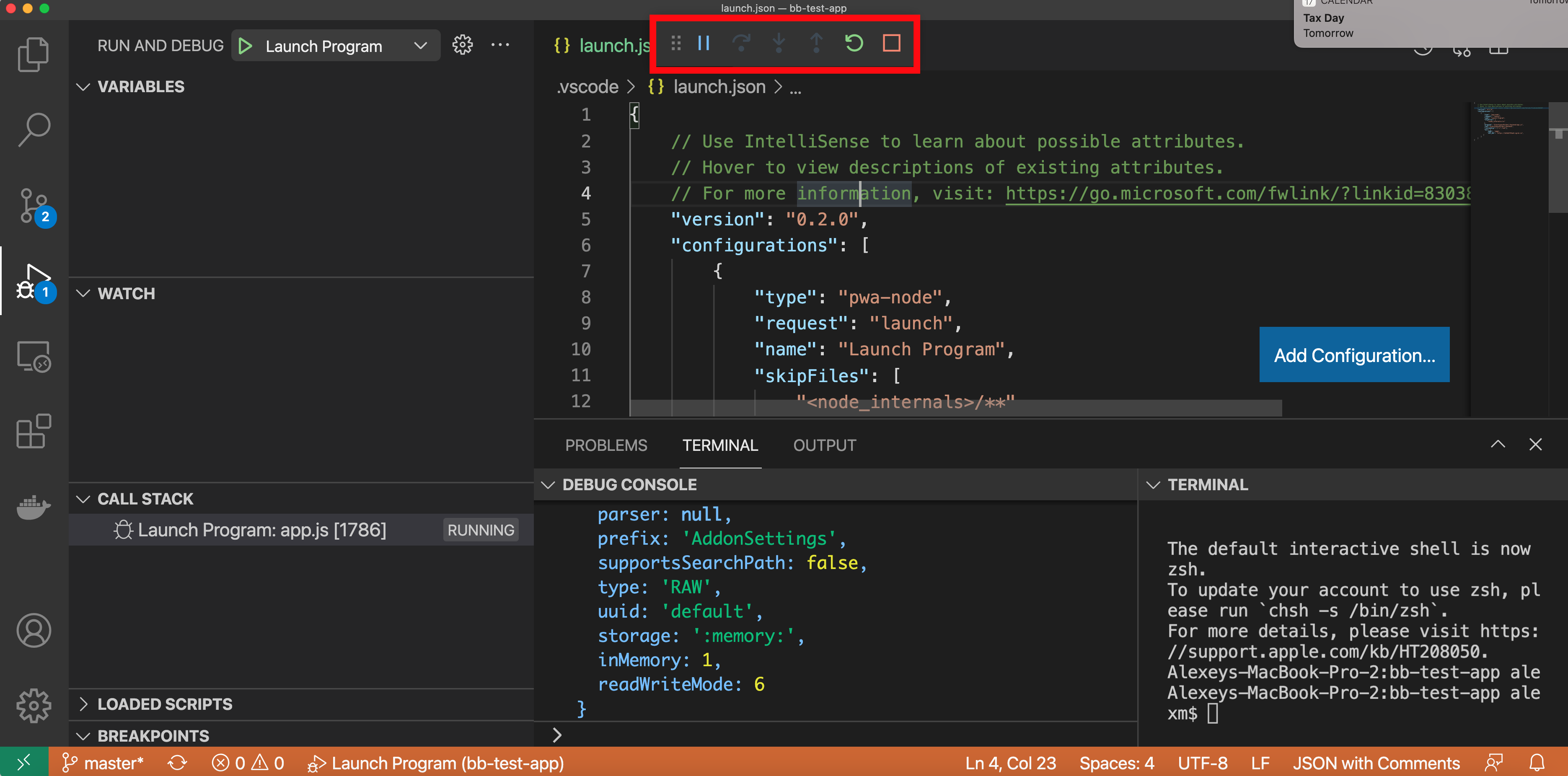

}Push the “Launch Program” button:
Now our app started but then we received an error:

The problem is that we defined several parameters in the backend/config.json file, which are taken from environment variables:
"port": "$PORT",
"localBaseUrl": "$APP_URL",When we run the debugger, the debugger does not read this variables from our environment. We need to pass our parameters in the launch.json file:

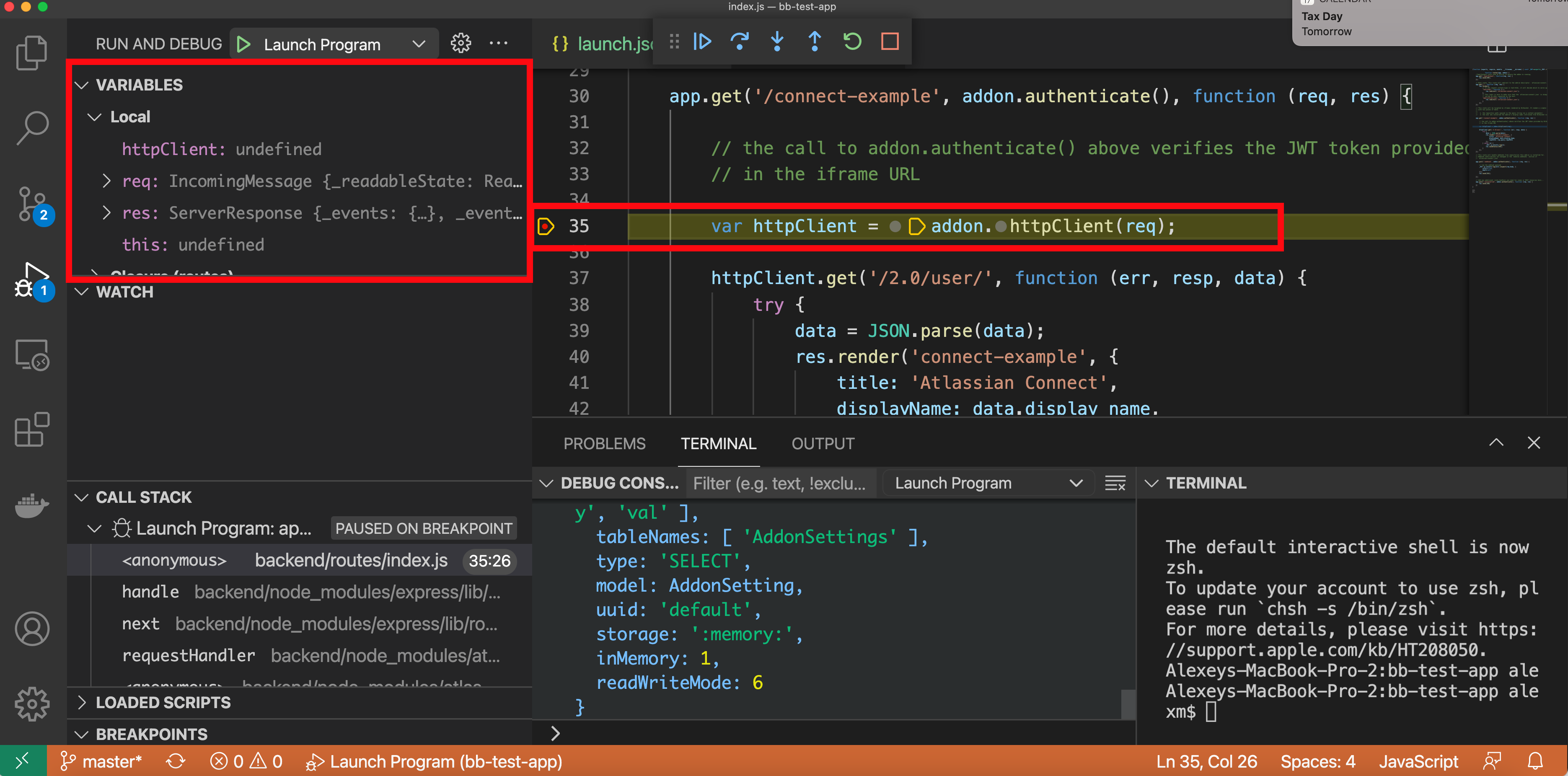

}Now let’s push the “Launch Program” button again. Our application is running now:
Test
Let’s test that everything works.

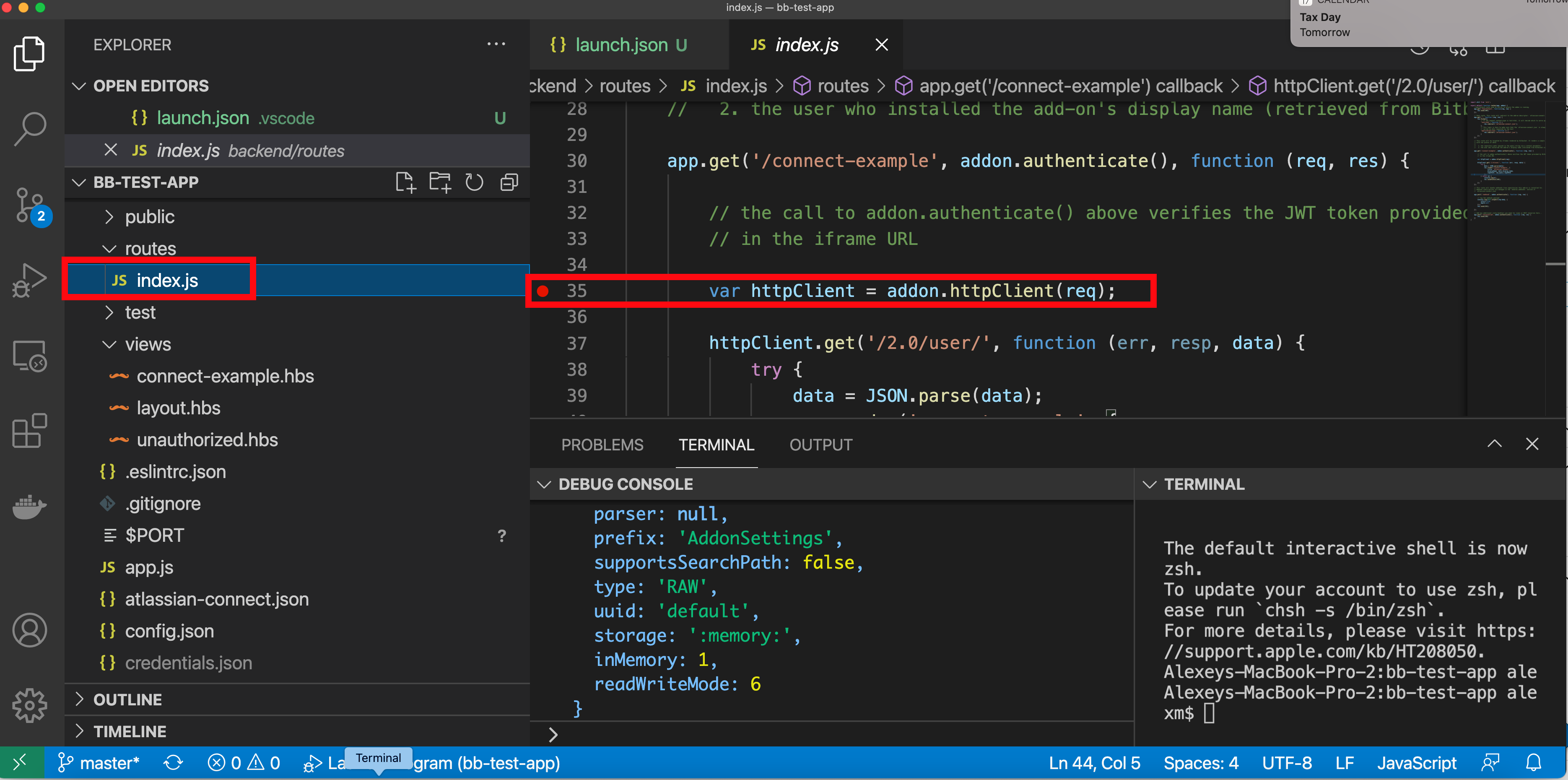

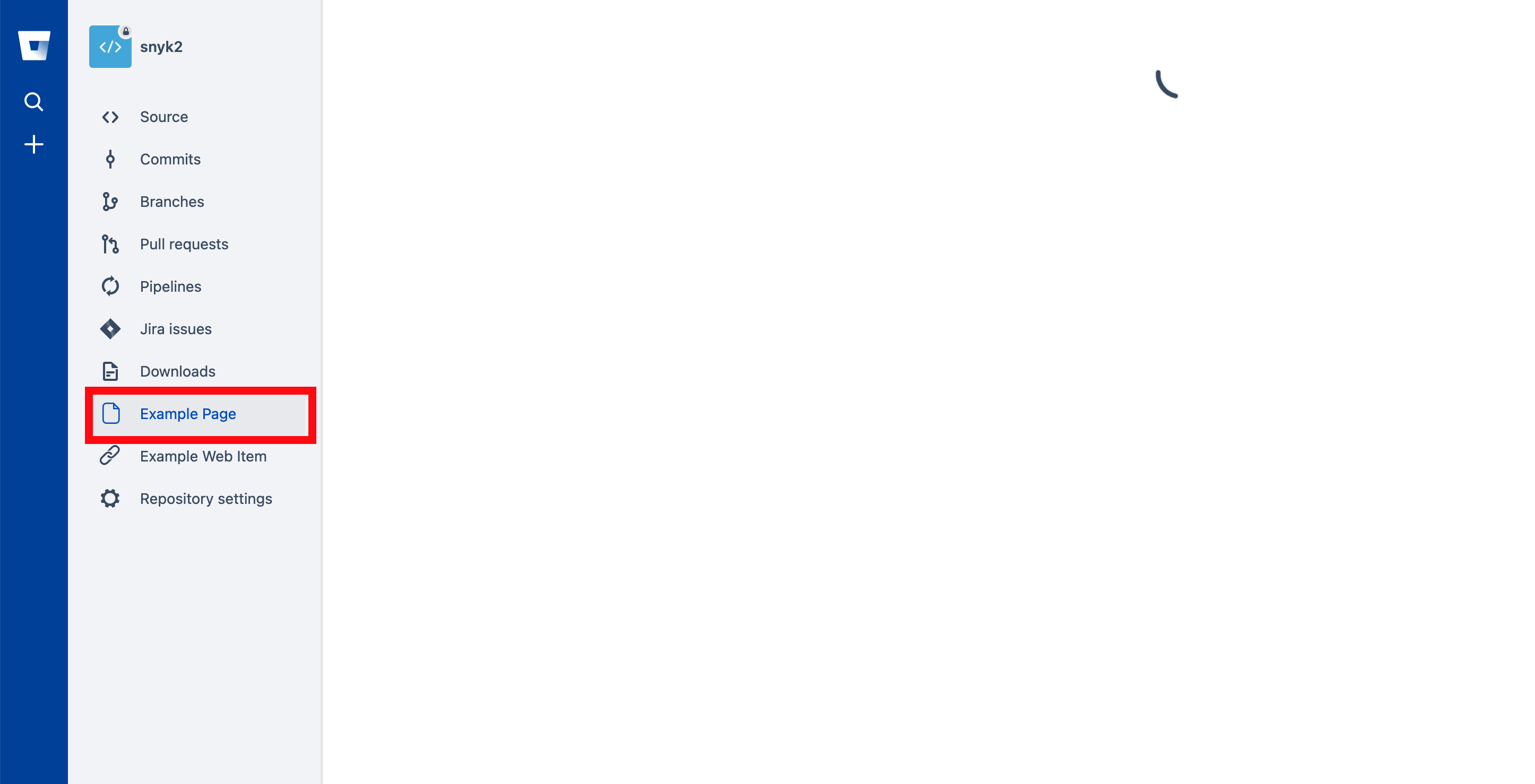

Install our app to Bitbucket and set a breakpoint in the backend/routes/index.js file:
Open the Example Page menu item:
And our app will stop on the breakpoint which we set:
Everything works as expected!
