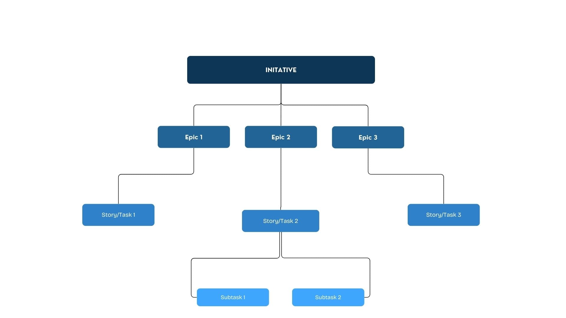

Hierarchy levels in Worklogs correspond with hierarchy levels in Jira Advanced Roadmaps. So, for example, hierarchy level 2 in the app will include all tickets that fall within number 2 in the Jira issue type hierarchy.
On the left: the Worklogs app | On the right: view from a Jira page
Whenever you display a particular hierarchy in the Worklogs app, it will always show the time logged into issues from this hierarchy level as well as issues from levels lower than this level.
For example, displaying hierarchy level 2 (“Initiative” in our example) will result in a Worklogs report showing the time logged into hierarchy level 2 (“Initiative”) and all linked Epics (including their tasks and subtasks).
So, higher levels will always encompass the lower levels which will be displayed together with them.

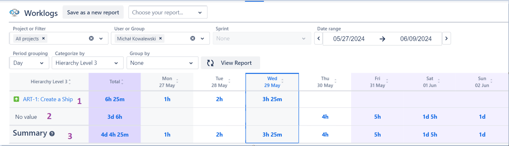

1. A Worklogs report with one hierarchy-level filter
The fundamental report you could create is the one that will present one hierarchy. In our example, it’s Hierarchy Level 3, so we set Worklogs as follows:
Categorize by: Hierarchy Level 3
Group by: none
The “total” next to this hierarchy level (1) shows a summary of all time entries logged for the Hierarchy Level 3 and lower levels - Hierarchy Level 2 and Epic (6h25min in our example)
The “no value” field (2) here will display all time entries logged for levels above Hierarchy Level 3. If you logged time for Hierarchy Levels 3,4,5,6,7, and 8 they will all be displayed here.
The “summary” field (3) will display all time entries logged for all hierarchy levels in the chosen date range.

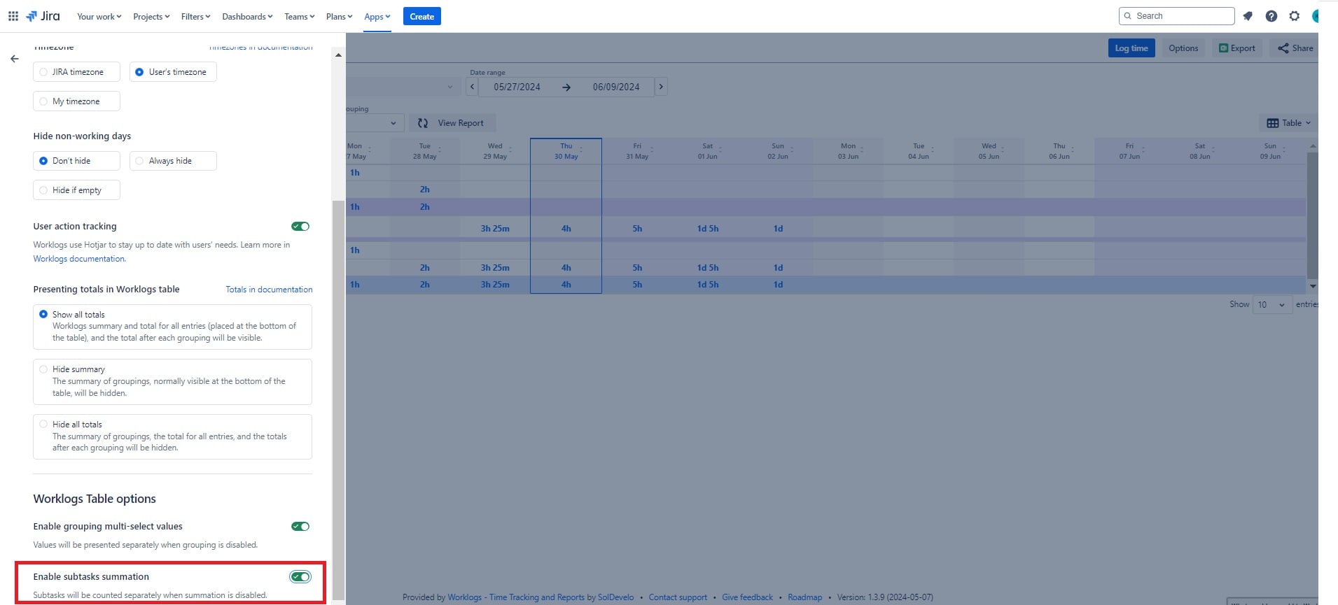

Displaying subtasks
When displaying particular hierarchies, Worklogs give you the option to either see time entries logged for subtasks in these hierarchies separately or to include them in the task/hierarchy they belong to.

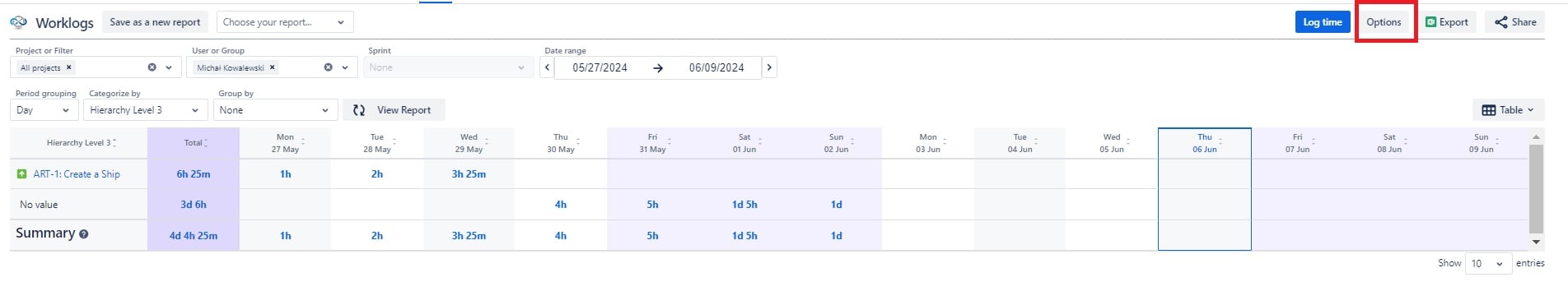

To enable displaying tasks separately, click Options on the right of your report.
A tab on the left will open. Select ‘Enable subtask summation’.
Then, your subtasks’ work logs will be shown separately in your report.

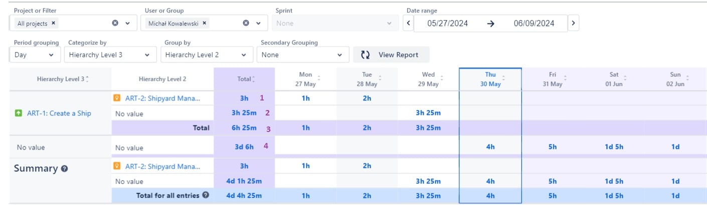

2. A report with two hierarchy levels
You can also prepare a more comprehensive report and choose to display two different hierarchy levels. In this example, we set Worklogs to:
Group by: Hierarchy Level 2
The first part of the report shows data as follows:
1- time entries logged for Hierarchy Level 1 + Hierarchy Level 2 (3h in our example)
2 - time entries logged for Hierarchy Level 3 (3h 25mins in our example)
3 - time entries logged for Hierarchy Level 1 + 2 + 3 (6h 25 mins in our example)
4 - time entries logged for Hierarchy Levels above Hierarchy Level 3 (3d 6h in our example)
Notice that the first part of the time report will show only the data for hierarchy levels included in the filters (Categorize by, Group by, Secondary Grouping).
Now, let’s move to the second part of the report - the ‘Summary’. The second part will include both the hierarchy levels from the chosen filters and all other hierarchy levels with time entries logged in the chosen date range.
The second part of the report (the Summary) shows us:
1 - time entries logged for Hierarchy Level 1 + Hierarchy Level 2 (3h in our example)
2 - time entries logged for Hierarchy Levels 3 and above (4d 1h 25m in our example)
3 - all time entries logged for all hierarchy levels - the total time logged in a given date range (4d 4h 25m in our example)

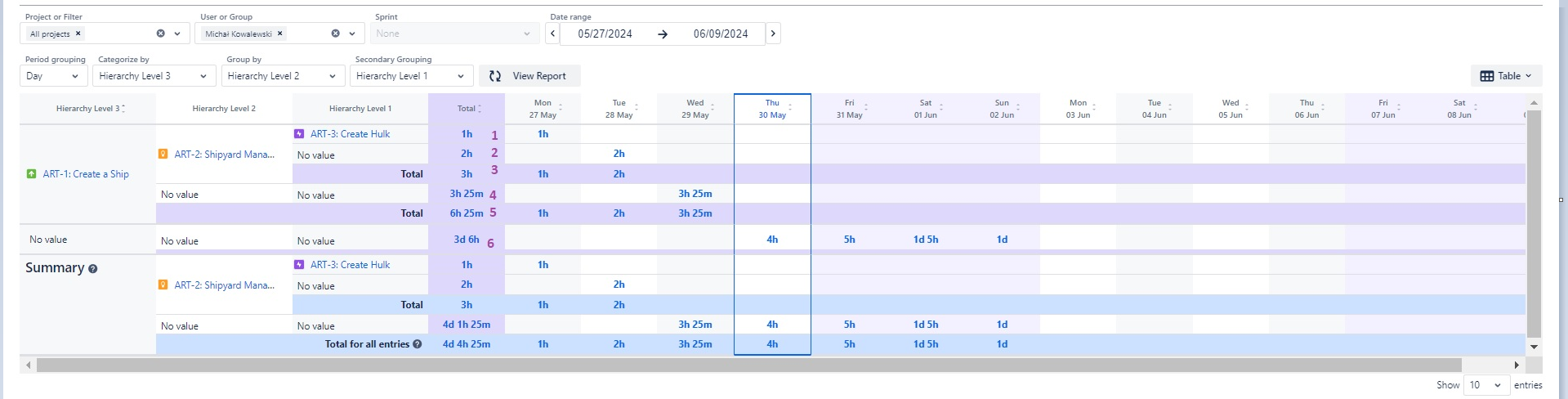

3. A report with three hierarchy levels
Another report is going to be a bit more comprehensive as we chose three different filters with hierarchy levels, it goes as follows:
Secondary grouping: Hierarchy Level 1
How to interpret this set of data? Going from the top, the first six rows are:
1- time entries logged for Hierarchy Level 1 (1h in our example)
2 - time entries logged for Hierarchy Level 2 (2h in our example)
3 - ‘the ‘Total’ row - a sum of time entries logged for Hierarchy Levels 1+2 (3h in our example)
4 - ‘No value’ row - time entries logged for Hierarchy Level 3 (3h 25min in our example):
5 - the ‘Total’ field - a sum of time entries logged for Hierarchy Levels 1+2+3 (6h25min in our example)
6 - ‘No value’ row - time entries logged for Hierarchy Levels higher than Hierarchy level 3

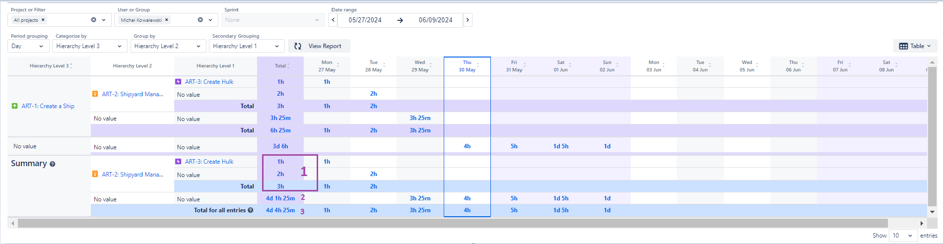

Moving to the Summary Field, the interpretation of data goes as follows:
1 - these rows are a repetition of what we saw in the previous part
2 - the ‘Total’ row is a summary of the time entries logged for Hierarchy Levels 1+2 (3h in hour example)
3 - the ‘No value’ row shows all time entries logged for Hierarchy Level 3 and all Hierarchy Levels above it
4 - the ‘Total for all entries’ row will show you all time entries logged for all Hierarchy Levels (the total time logged in a given date range)
