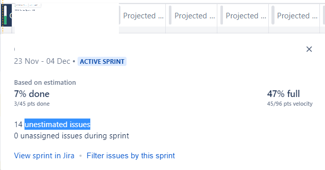

Issue:
Portfolio tells me that I have 14 unestimated tickets in one sprint in the capacity view of a teams sprint. But I can not figure out, which tickets are unestimated. See first pic

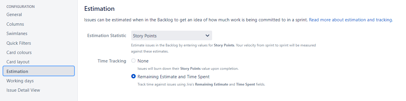

Hello @Walter Buggenhout
Thank you for your answer.
Unfortunately, all Standard issue types have Story point estimations.
Only the sub-tasks do not have story points. Is portfolio expecting a story point estimation also on sub-tasks?
Can I turn this off somewhere?

Hi @Christian Huss,
The easiest way to figure this out, is to simply click the link Filter issues by this sprint as per your first screenshot.
Then, limit the hierarchy in your plan so you can only see the story level (and optionally sub-tasks).
Make sure you add the Story Points custom field to your view. All issues that don't have an estimate are your unestimated issues:

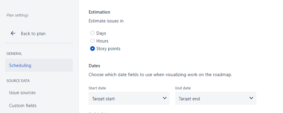

I am not aware of a way to include sub-tasks but exclude story points from the sprint statistic. If you don't use the sub-tasks for estimation, you might maybe consider excluding them all together from your plan.
Plan settings > Exclusion rules > exclude issue type sub-task
I haven't been able to test that approach as I don't have test data at my disposal. But you could try without the risk of losing information.
If that doesn't work - don't bother. I'm sure you have all the processes in place to not start a sprint without unestimated issues in place - I guess that's why you ask the question probably. And the most important thing: all estimated issues ARE counted to calculate the load % of your sprints.
I could not find the Plan settings > Exclusion Rules entry. Maybe I do not have the correct version.
