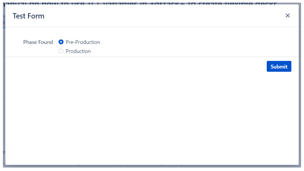

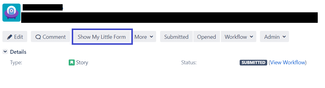

I’m trying to implement a feature through ScriptRunner that involves extending the Jira “issue details” screen using a web fragment (a button), which in turn shows a dialog box with a form. For the purpose of demonstrating this issue, I have kept the implementation to a minimum (the form only contains a couple of Radio Buttons and a Submit button).
 To summarize:
  1. I have a new button (web fragment) on the issue details screen that is tied to a REST endpoint that I implemented in ScriptRunner
  2. The REST endpoint returns the dialog to be shown with two radio buttons and a Submit button. Upon hitting the Submit button, a JavaScript dialog pops-up displaying the number of radio buttons it found on the form (this should always be 2).
However, when I execute the following sequence, my JavaScript somehow thinks bumps up the radio button count by 2 upon every single invocation of this sequence.
  1. Click on the button “Show my Little Form” to bring up the form (works as expected)

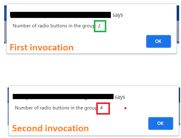

  4. You should see the JavaScript pop-up with the message “Number of radio buttons in the group: 2” (works as expected)

  7. Try to select between the two options. You will notice that the second radio button is not selectable (problem #1)
  8. Now click on the Submit button. You will notice that the number of pop-ups is now 4 in the message (problem #2 – this should have been 2 and not 4)
  9. Repeat steps (5) through (8) and see the number go up by 2 every time.

def dialog =
<section id="static-dialog" class="aui-dialog2 aui-dialog2-large" role="dialog">
${header}
${formContent}
${footer}
${scripts}
</section>
Response.ok().type(MediaType.TEXT_HTML).entity(dialog.toString()).build()

It turns out that every time you click the button, your dialog html is embedded into the DOM and when you close it, the html is still in there.
Every time you click the button, you get another copy in the DOM.
You can avoid this by adding the data-aui-remove-on-hide attribute to the section tag
<section id="static-dialog" class="aui-dialog2 aui-dialog2-large" role="dialog" data-aui-remove-on-hide="true">

Thank you so much, you're awesome! :) This took care of both problems I described in my post. I also appreciate the explanation of what's going on with the DOM every time the button is clicked - it makes a lot of sense now.
