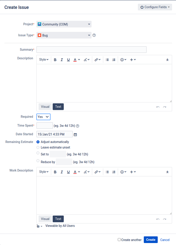

Below is a print screen of the Behaviour configuration:-
Below is a print screen of how the Behaviour works:-
When the issue is being created, if the option selected in the Required list is Yes, the Time Spent field becomes mandatory else it is not.
