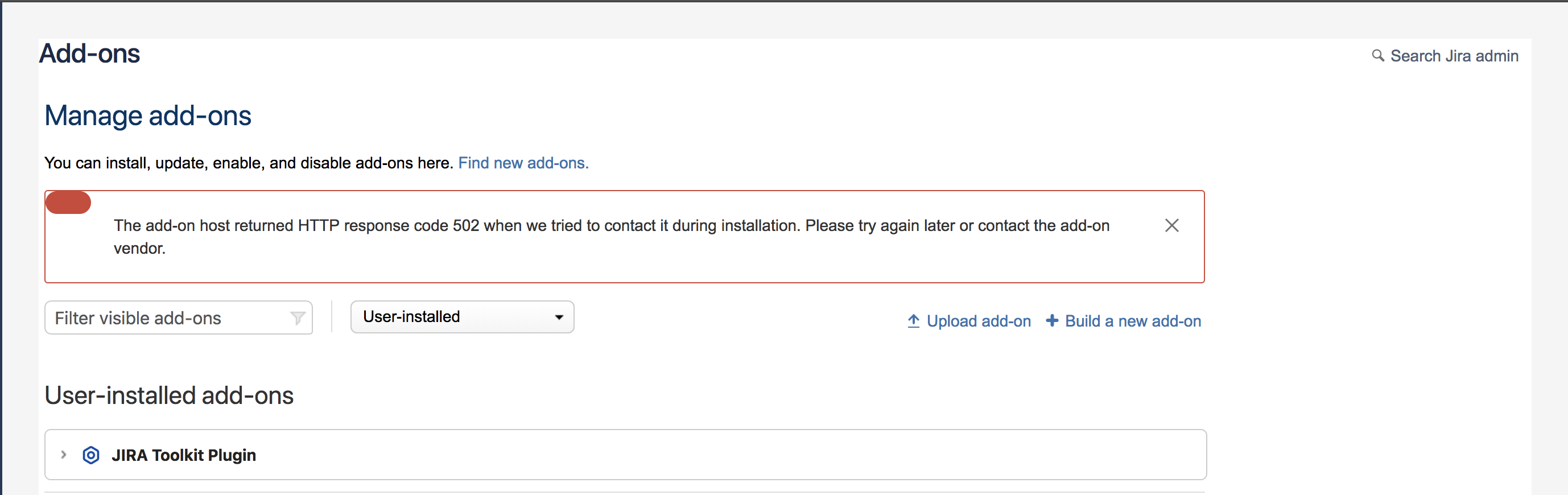

Unfortunately, after the 404 was fixed, we now get a 502 error when we try to upload our addon. Checking the traffic that's hitting our endpoint, I see a 200 from Atlassian hitting us at the `/atlassian-connect` endpoint, where we return our `atlassian-connect.json`. That is the only endpoint getting hit on our end and our server logs no errors. (See image below)
Again, if we run our app locally and use ngrok, none of these issues occur.
