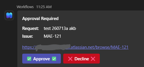

-the assigned approver would receive a Teams card letting them know they have a JIRA Ticket to approve
-the Teams card would have *active buttons* to click to "Approve" or "Decline"

When making another test user an approver? He gets the Teams card with the buttons OK. and can click his response, OK; But Power Automate, using my credentials to authenticate the API to send his response back gives a 403 Forbidden error in Power Automate (or maybe from JIRA that Power Automate is relaying?)
