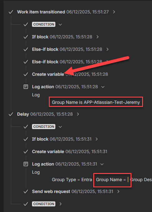

Hello, i am having some problems with my automation and variables and am looking for some help understanding why this isn't working.
The first step in my automation is to create the variable. The Variable is set based on a custom field using a series of if else statements. In this picture the custom field was Application, so the variable should be "APP-{{Application name}}" (Atlassian-Test-Jeremy). The if statement works to cerate the variable and then logs that.
The second step logs several pieces of information from the ticket that will be sent as part of a web request further down the automation. In this step i try to pull the variable Group Name that was created in step 1, but it comes up blank.
I tried adding a delay before step 2 and that didn't seem to do anything.
Before you ask, the 2nd Create Variable seen here is creating a different variable. Its not overwriting the one from step 1.
