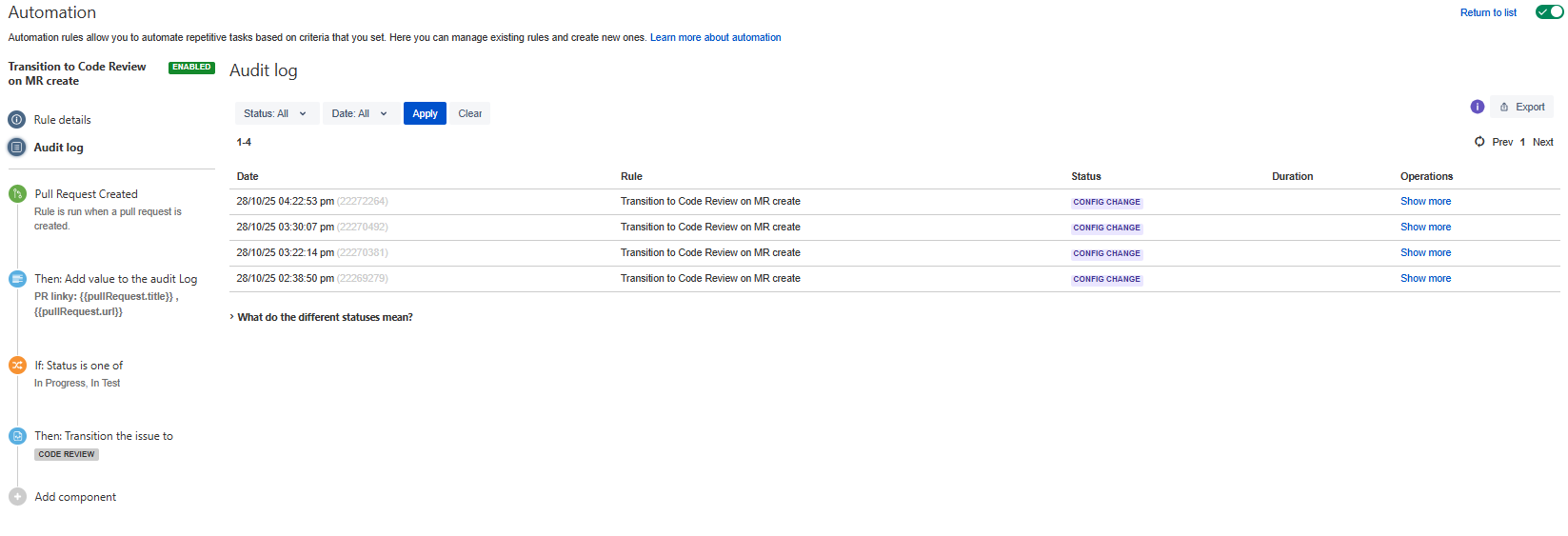

I have been trying to get an automation to trigger when a Merge Request is created, to transition the Jira issue to code review.
GitLAb documentation implies that the 'pull request created' trigger should do this (though they call theirs merge requests...),.
I keep getting emails such as:
Hi
The automation rule Transition to Code Review on MR create just failed with an error on your Jira instance (https://jira.int.kn).
Please check the audit log for more details in the automation admin section (#22272201).
To stop receiving these e-mails, please update your notify on error settings in the rule details for this rule.
Cheers, Jira automation
However, when I check the audit log for the automation rule,. I can't see that it triggered at all. I even tried adding a value to the audit log, immediately on the trigger, but there is nothing!
