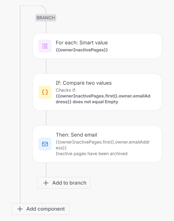

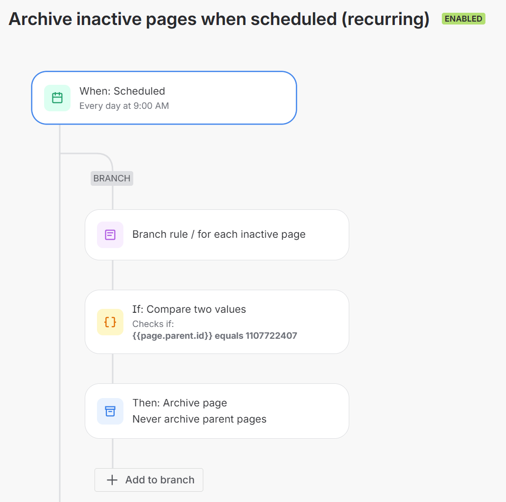

I'm trying to build a rule in our space that will a) archive pages that have been inactive for over a year and b) notify the page owner that their pages have been archived. I started with the "archive inactive pages" and "notify owners of inactive pages" templates and have been modifying and testing it, but I'm running into some problems I don't know how to resolve.
Some factors I'm working with:
- I need to be able to exclude (or include) sections of spaces where content shouldn't be archived.
- The email notification is necessary because the auto-notification Confluence sends doesn't provide any context and, knowing my users, a nonzero percentage of them will freak out when they get it. So I need to be able to send a custom message on archival.

Currently the flow looks like this:
Problem 1: The flow is wrong.
Here's how I would want the flow to work:
1. Identify inactive pages.
2. Apply exclusions or inclusions, if they're present.
3. Archive pages that fit the criteria.
4. Send the owner of those pages an email informing them of the archival.
Here's how the flow actually works:
2. Apply exclusions or inclusions.
4. Send the owner of the pages identified in step #1 an email informing them all pages have been archived, regardless of exclusions/inclusions and if those pages were actually archived or not.
How do I get that second branch to pull the "pages archived in step 3" value, rather than the value in step 1?
Problem 2: The "If" condition isn't working.
This one is set up very simply so I don't know how it's going wrong. It should be comparing the parent page of each inactive page to the specified ID and seeing if there's a match. I know it should be pulling up results, based on what I've configured. However, every time I run it, I get the "Unable to render smart values when executing this rule: Failed to get value for page.parent.id" error and it doesn't identify any pages at all.
I had this rule working correctly in my personal space, but when I duplicated it into a communal space, now it doesn't work, and I have no indication of what's causing the error.
I'm hoping someone can give me some insight here - I've reached the limits of what little documentation I can find. Thanks!
