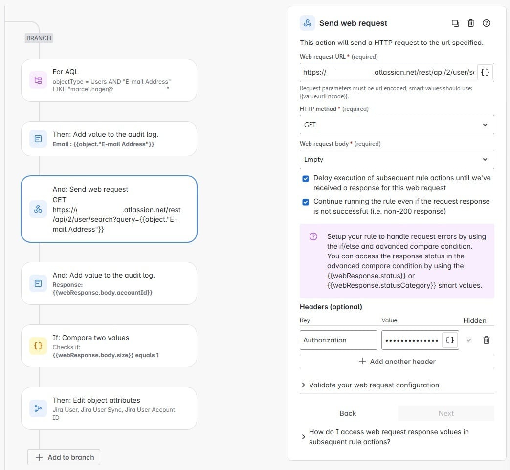

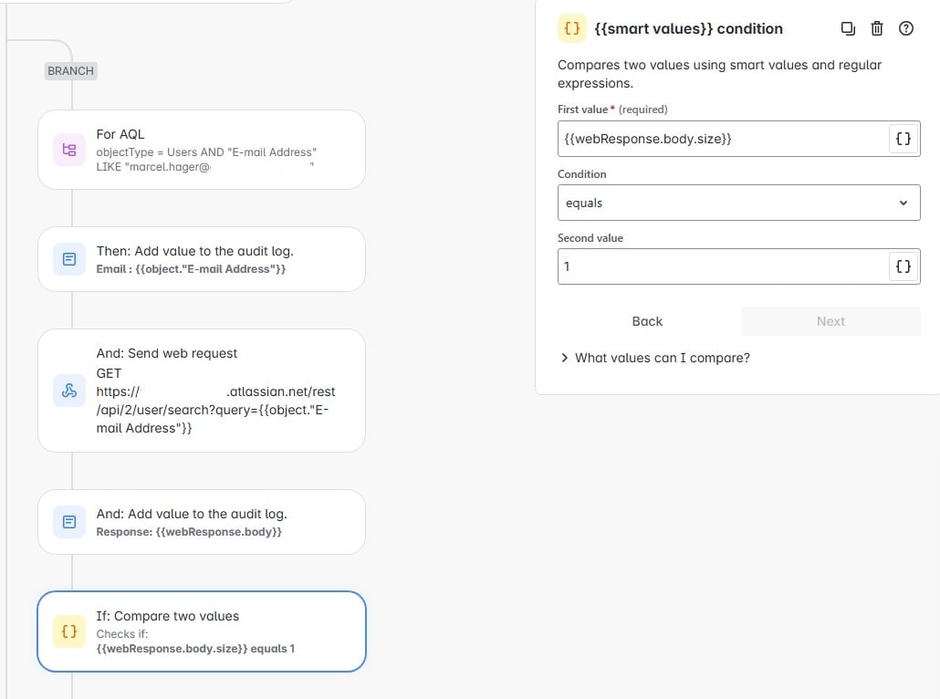

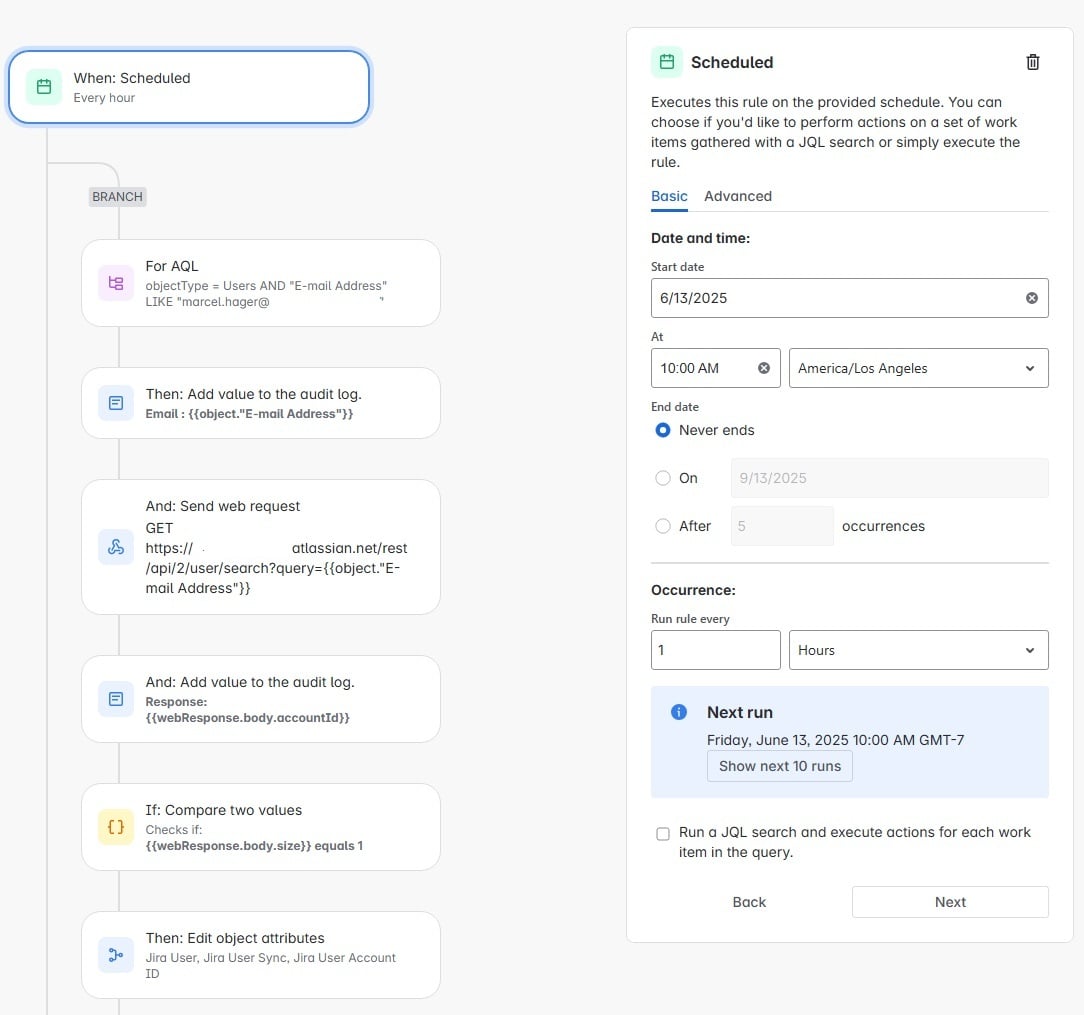

Now when I go to set up the automation however, this is where the issues come in. Below is the current configuration that I have, after following posts and guides that I've read. For this specific automation, I'm trying to update my own user record in assets so that I can ensure that it's updating at least one record correctly.

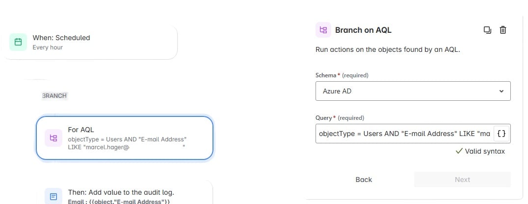

Step 1: Currently scheduled every hour but allows me to run on demand to test.
Step 2: AQL to find the object with a specific E-mail Address

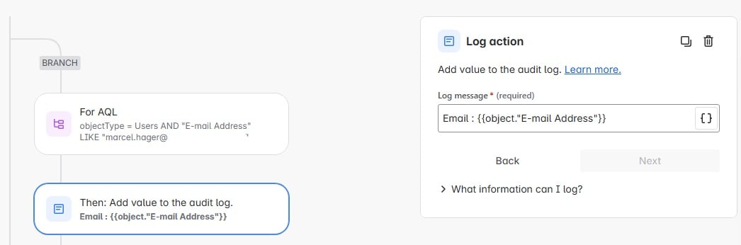

Step 3: Log the object E-mail Address so that I can confirm what is being passed into the web request
Step 4: Send the web request using the object."E-mail Address"

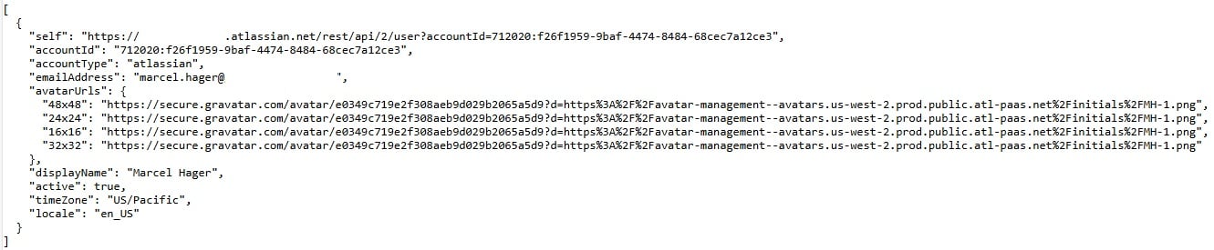

This is where things start to have issues, I think. If I plug the web request into a browser, it returns what I'm expecting:

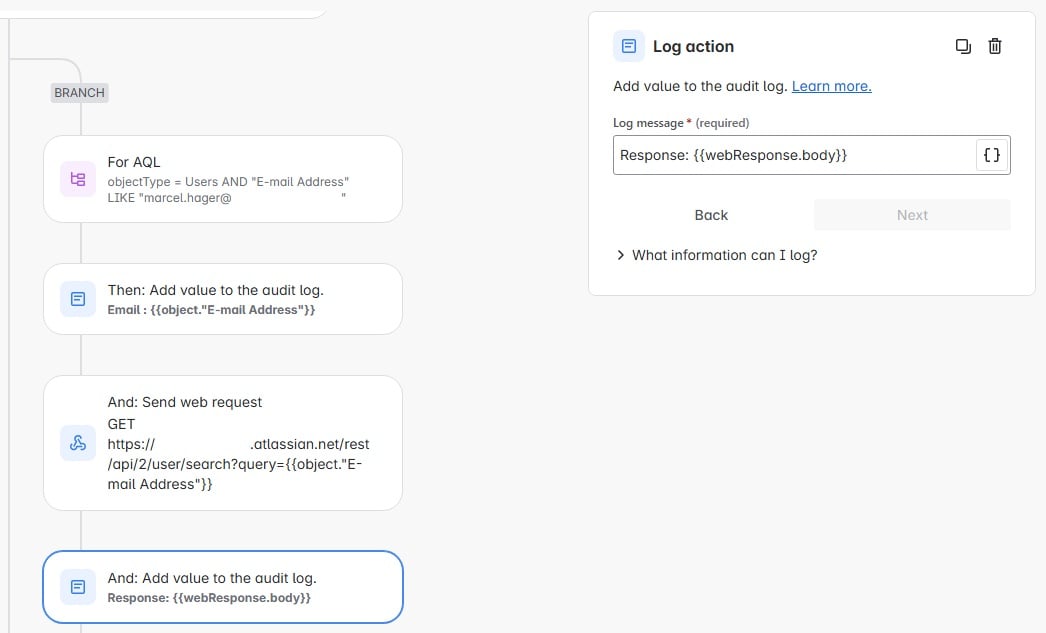

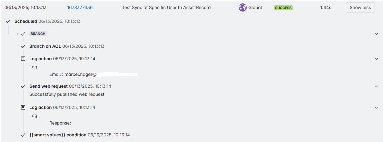

I try to log the webResponse to the audit log so I can see what is returned, but no matter what I've entered here I seem to get an empty response. I've tried using {{webResponse.body}}, {{webResponse.body.accountId}}, and just {{webResponse}}, and the only time anything shows in the logs is for {{webResponse}}.
Audit log:
Step 6: Now if the web response would actually return properly, the comparison for the webResponse would happen here.

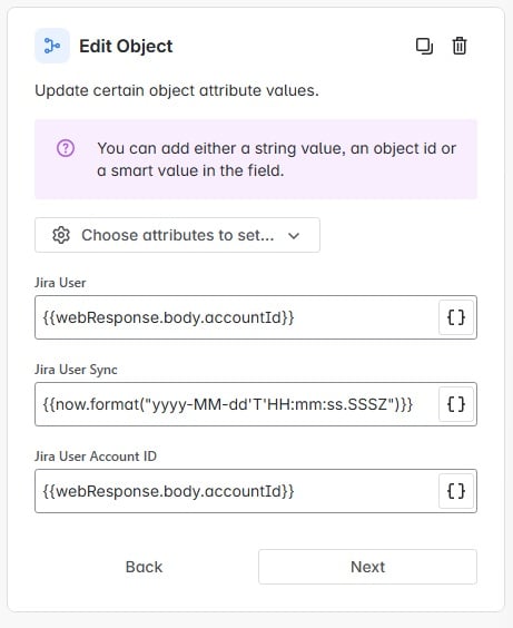

Step 7: This should be able to take the web response and parse it to find the values I need and use that to set fields on the asset, but this is not happening.
