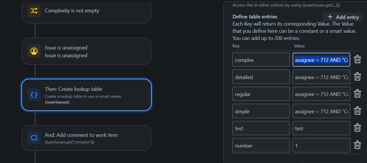

I'm currently stuck with a lookup table to reference all of the jql for the first user
the value is {{assignee = (firstuserid) AND "Complexity[Dropdown]" = Complex}}
This is the jql query that will tally how many work item issues are assigned to each user based on complexity, so that I can do the math for the weight load with it and not assign it to the user if the weight is above 30.
I've tested it to comment on the work item, but it says that the value is empty.
I've also tried it with the raw JQL but it just returns the string of the actual JQL instead (assignee = (firstuserid) AND "Complexity[Dropdown]" = Complex)
I think the jql I'm putting in might be wrong or might not be able to be parsed by the lookup table, but any help is appreciated thank you!
