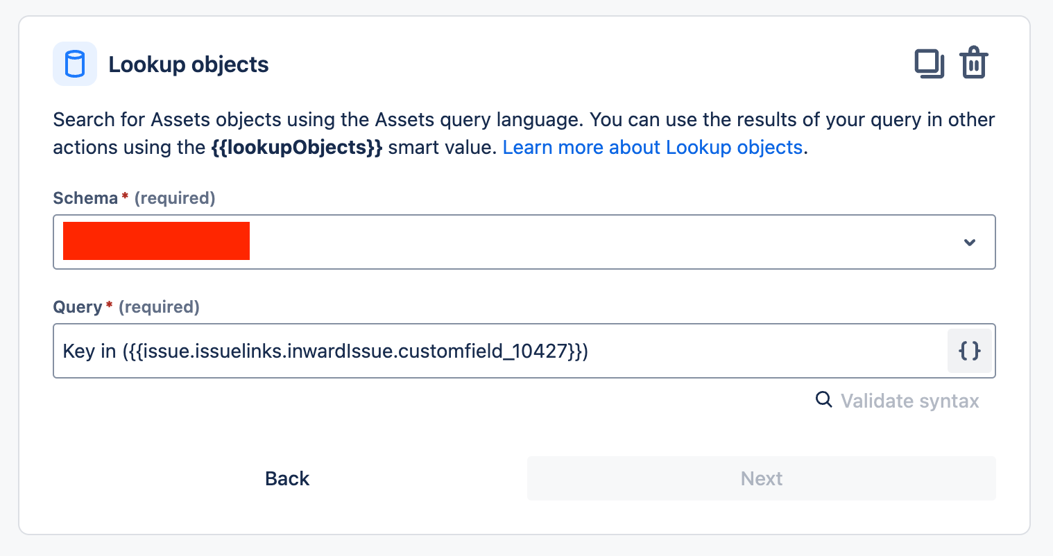

1. Using lookupObjects
Then, we use edit issue in the automation with:

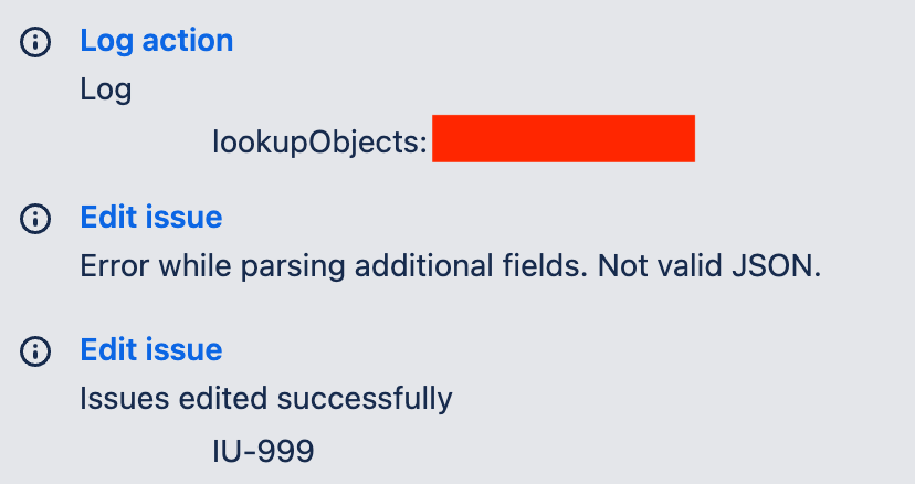

"fields": {
"customfield_10425": [{{lookupObjects}}]
}The audit logs shows us the json field is not valid.

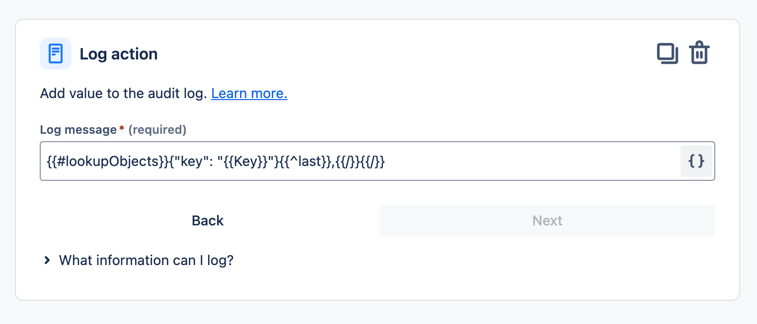

Then we tried to transform the data to be a valid json format as:
{"key": "xxxx"}by using {{#lookupObjects}}{"key": "{{Key}}"}{{^last}},{{/}}{{/}}

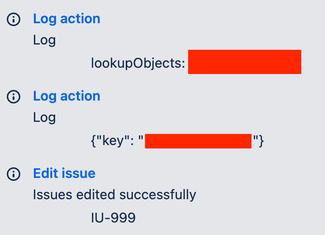

2. Using tranformed lookupObjects
"fields": {
"customfield_10425": [{{#lookupObjects}}{"key": "{{Key}}"}{{^last}},{{/}}{{/}}]

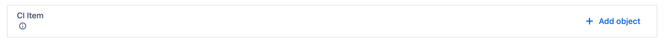

The audit log and the automation run is success; However, the field didnt have a value we have passed.
